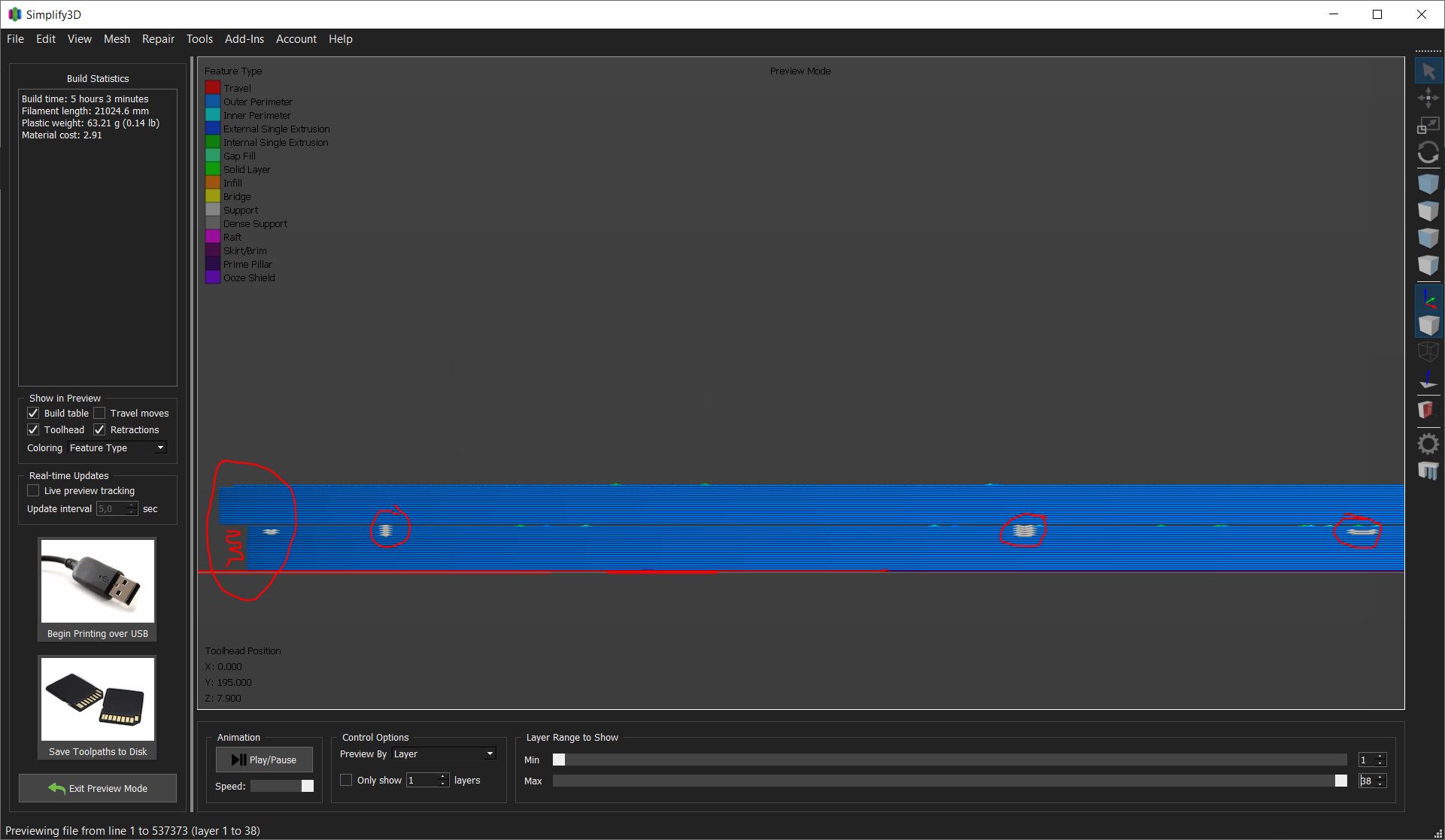

While it's propably not the single cause you should check support generation settings. I can't really see why you're using supports on this
print - but there's a lot of short support extrusions which will stick to the nozzle and get dragged along:

All those tiny extrusion are far enough from the walls to just stick to the nozzle....
Right now I can't see anything else obvious "wrong", z lift is active. So if there's more plastic than the supports hanging from the nozzle it's
hard to tell from the gcode.
Did you do any retraction tests, are they working properly/clean otherwise? Maybe you can recreate the problem using two simple boxes
or something. The factory file would be much smaller then and others could have a look at your settings.
Edit:
Here one of those support extrusions stuck to the top on the last layer:

The gcode you added does have supports, yes. But there is absolutely nothing requiring them... unless the gcode file is only showing parts of the print. But the supports inside the hole are pretty useless - there's nothing to support on top...

Keyhole: With that many solid layers on top I'm pretty sure this should work without supports (and maybe 1 layer of bridging).
Anyways, all the tiny spots all around at layer 18+ (first gcode file) have nothing to adhere to and will get dragged all over the surface (there's 30-40 of them on the in- and outside).
And looking at it... I actually don't understand how you expect this to be a nice print. The black part is much bigger than the purple one:
There's absolutely nothing supporting the black part all around...?! You should definitely check your support generation settings.... ^^
