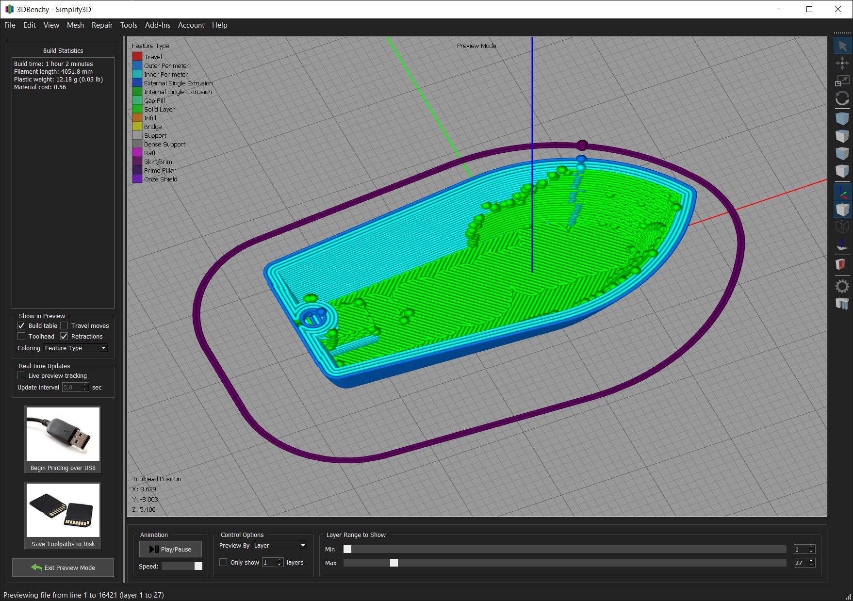

Squiggly interior wall in front of inside perimeter on 3dBenchy
What cases this squiggly wall on the 3dbenchy. Infill is set to 0%. See attached profile.

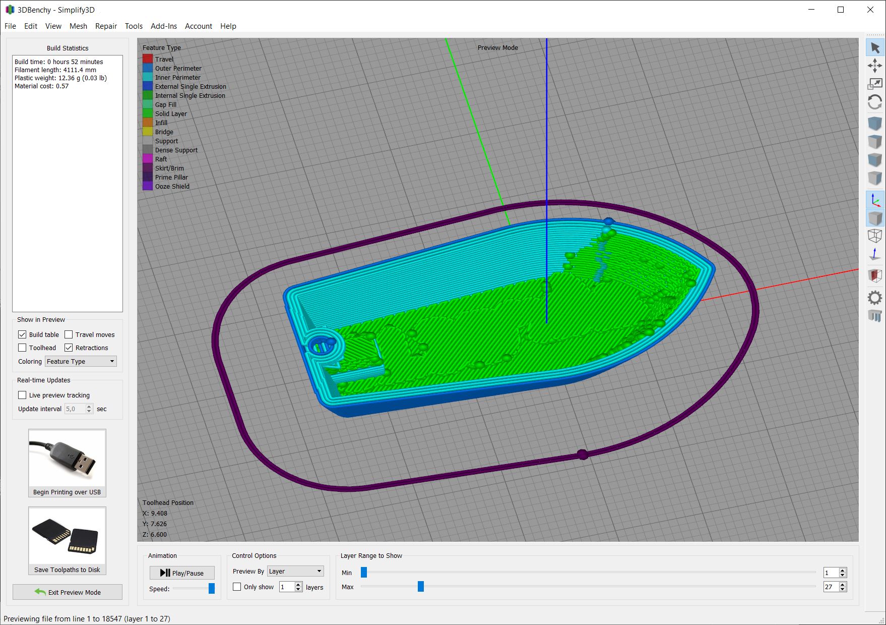

xnaron wrote: Wed Oct 14, 2020 10:16 pm I put it on my google drive
xnaron wrote: What cases this squiggly wall on the 3dbenchy. Infill is set to 0%. See attached profile.
For some reason S3D is adding some infill for top/bottom layers on the inside of overhangs pretty fast.
You can change the amount of top/bottom layers and/or extrusion width/perimeter count to see some differences:
There's so many perimeters and so much overlap, I wonder why those parts of solid infill need to be there. On some
objects this can add a lot of print time without real benefits... :(

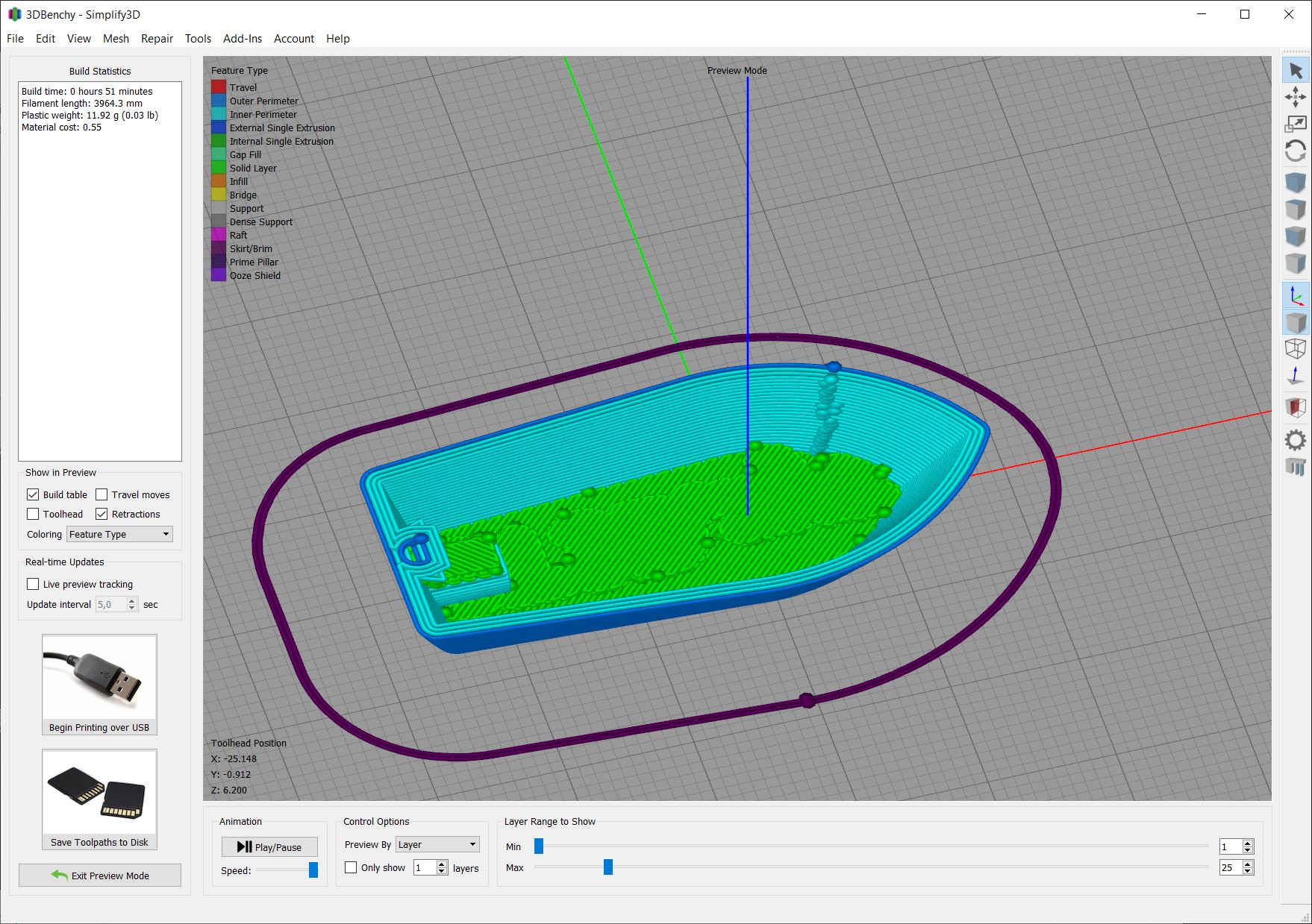

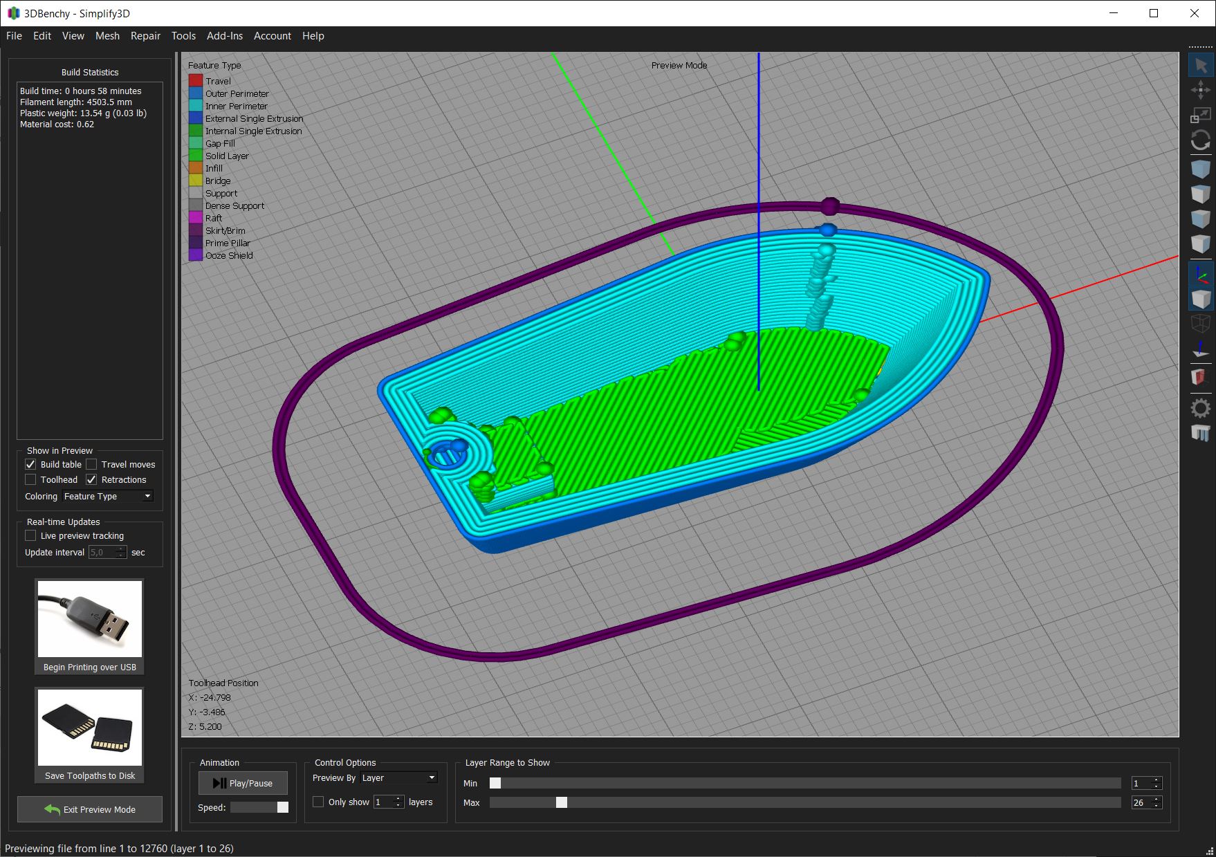

FWIW, this was also different in previous versions of S3D (<4.1):
Factory file from xnaron in S3D v4.0:
Same file/settings in S3D v4.1.2:
Reducing bottom layers from 5 down to 3 avoids this in 4.0 (v4.1.2 needs bottom layers set to 1):

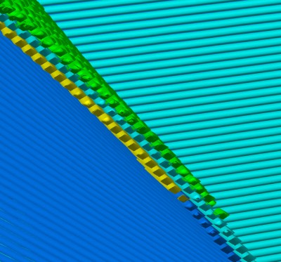

Basically when you are printing surfaces at an angle they create a stairstep. Each step of the stairs is a top or bottom of the part so it must satisfy the Top and Bottom Layer Settings you have. Dkightley does a great job describing this with his diagrams in the second link I included above.
Re: Squiggly interior wall in front of inside perimeter on 3dBenchy
I think this post of mine tells the story behind this issue :
viewtopic.php?f=9&t=14020&start=10

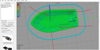

I'm trying to understand what the above and the graphs you guys created (viewtopic.php?f=9&t=13796&p=52184#p52168) mean for the model I use as an example.
In the cross section view I cant seem to see what you are explaining. What am I missing? Is it coincidence this starts building up where bridging happens on the outermost perimeter?
