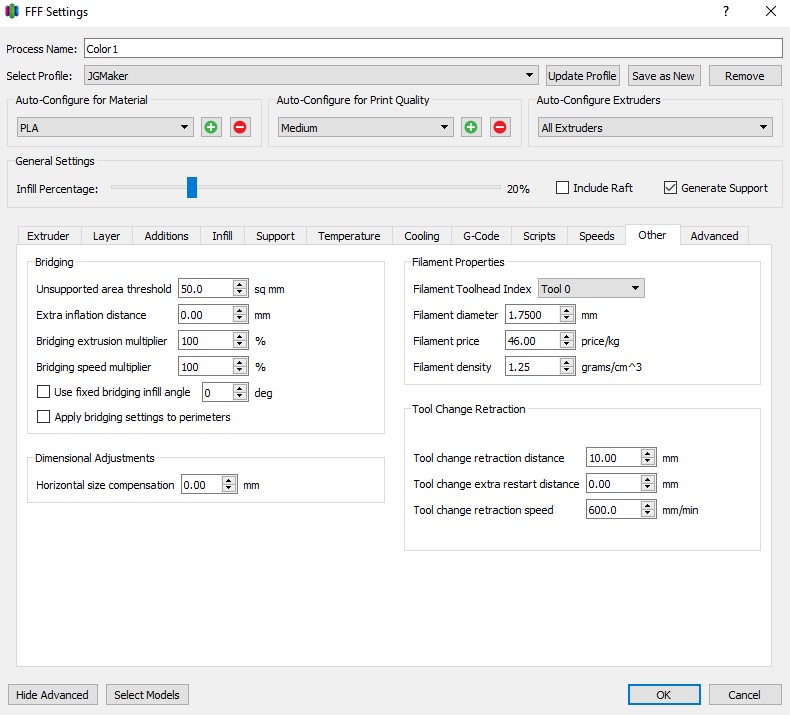

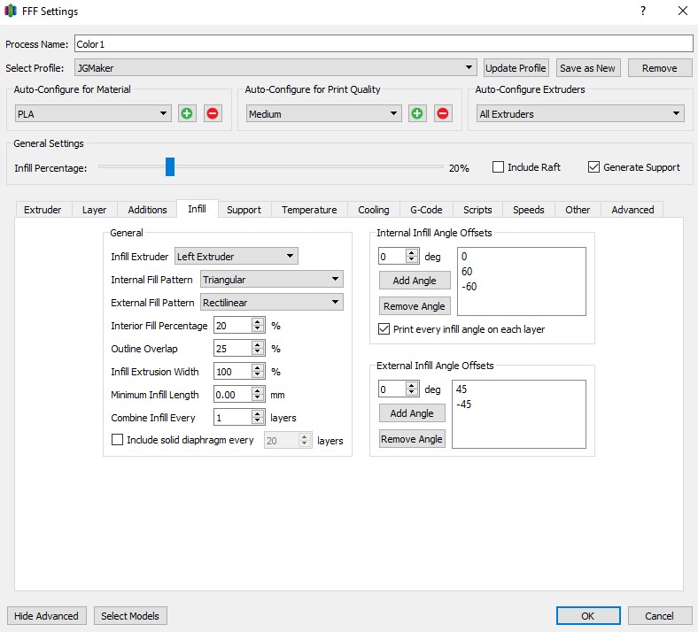

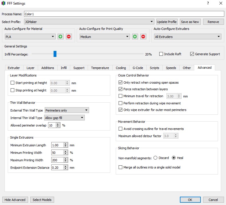

Here are my settings:

Re: Help please. Settings for JG Maker Artist-D Pro
With a bed that out of alignment my first bet would always be to replace the bed. Otherwise you're going to keep having issues with areas near the middle being too squished and areas near the edges being more how you want them to be. Or if you level it according to the very middle, you'll have the middle how you want it to look and then the closer you get to the edges the more likely your parts are to become too spaced out or not adhere properly at all.
15mm retractions at 1800 mm/min is going to cause the toolhead to be stationary during a standard retraction for quite a while. This can lead to blobs being deposited onto your part while the extruder is hovering there. Have you not seen issues with this?
Just to make things easier for others to come here an offer their advise you may want to upload your FFF profile rather than screenshots of every tab from the edit settings window.
