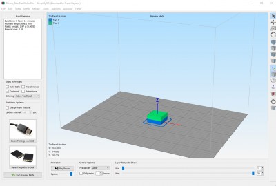

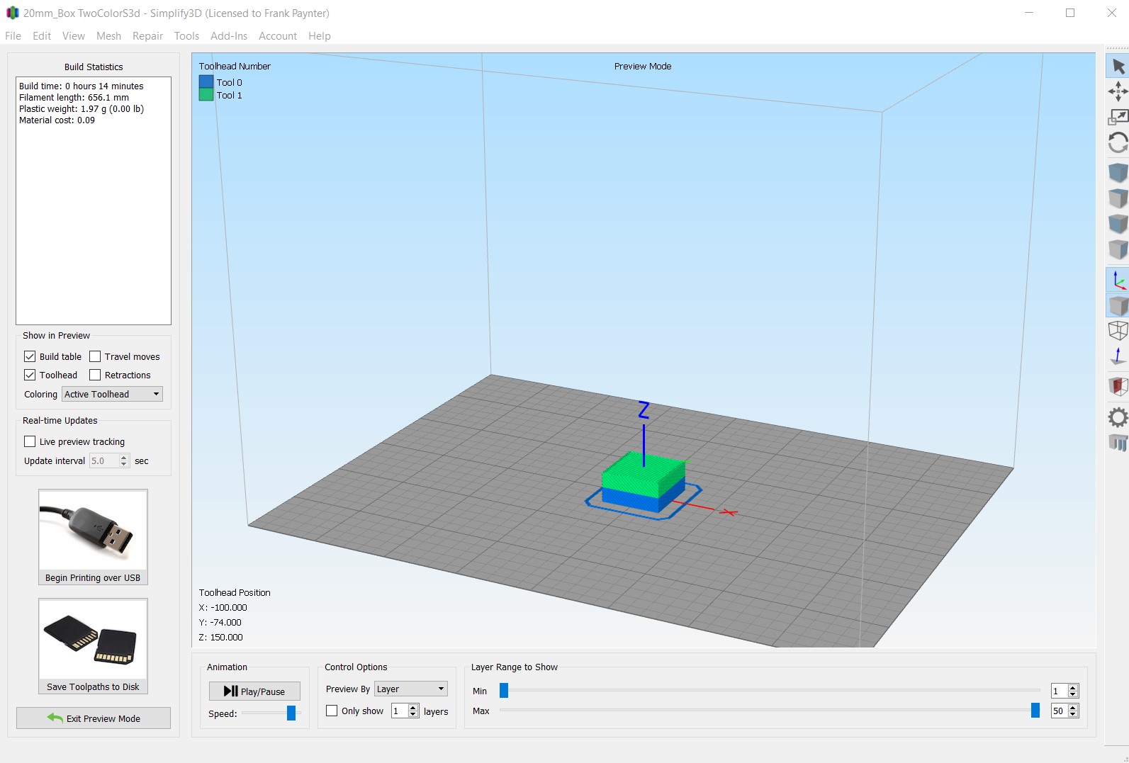

I have a new FlashForge Creator Pro 2 IDEX printer and I'm trying to use S3D for two-color prints. I have a 20x20x10mm test cube, and I'm trying to print the bottom 5mm in one color, and the top 5mm in the other. I can do this successfully using FlashPrint5, but when I try the same trick with S3D using two processes and the advanced setting for start/stop print height, the model gets printed entirely with the right extruder. The gcode preview in S3D looks correct, and I can see a tool change command in the gcode file at the right place (layer 26 out of 50), but obviously the tool change doesn't actually happen.
I have tried selecting the 'right extruder only' for one process, and 'left extruder only' for the other, but this doesn't seem to work at all. Selecting 'All Extruders' for both processes allows the print to complete, but as I mentioned above, only the right extruder is used for the entire print.
