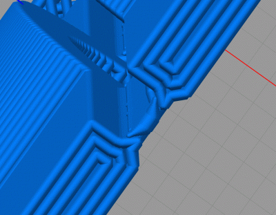

Im trying to print a living hinge, and I want the filament to cross the hinge space without stopping.
right now, Simplify draws/fills both sides, and then puts in a short one line wide connector.
I'd like it to print the entire outline as a single line instead so the hinge is continuous
in that spot.
Any ideas?

Looks as if you're getting single extruded outlines generated for that area. If you change the external thin wall option to perimeters only does the hinge print as part of the object like you wished?

Nope... Then its gone.
That thickness is one 0.4mm width, and its pretty long, so that it can bend in the right spot.
I can send you an STL to play with, or even an inventor model or step file... LMK if that would be helpful.

External single extrusions will get printed as their own "pass". So you would need to modify the width of the hinge in your model or change the extrusion width used in your extruder controller in order to force this area to get printed using "Perimeters Only" setting.
