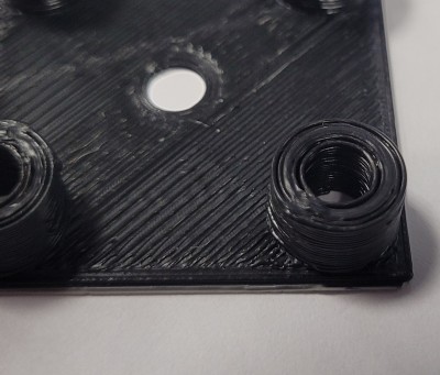

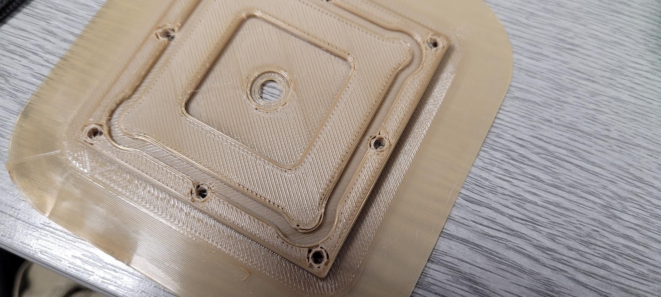

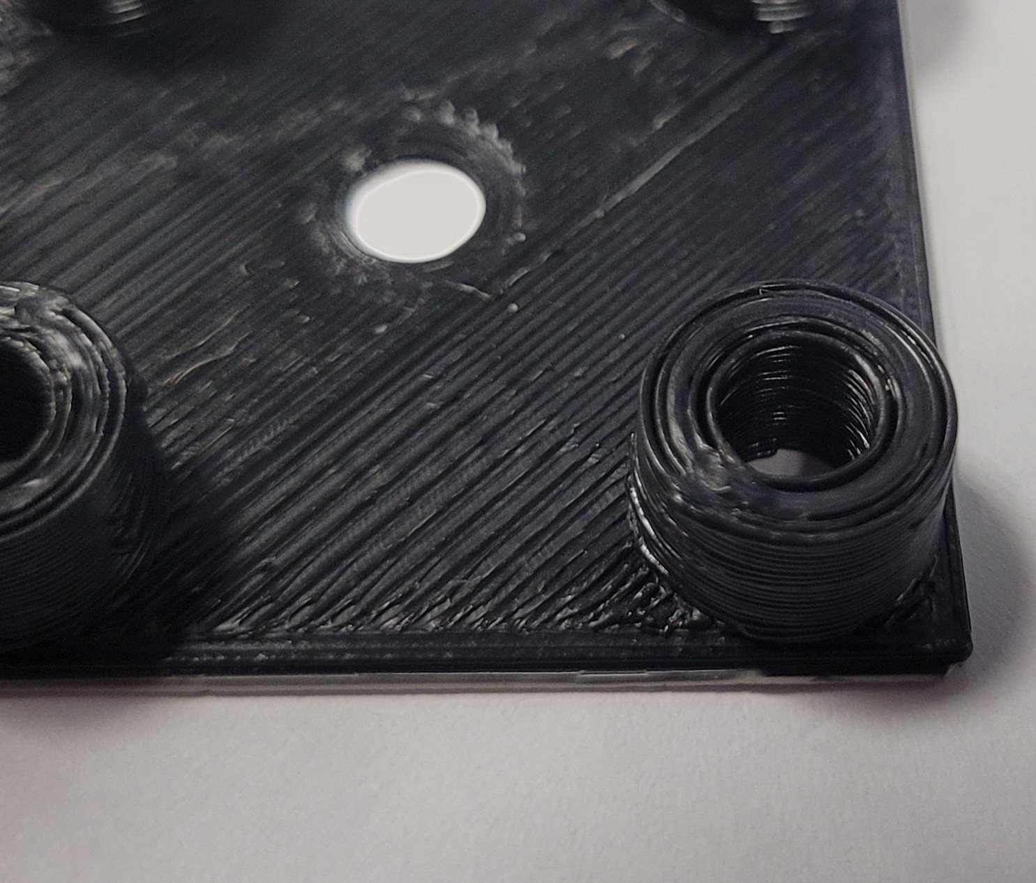

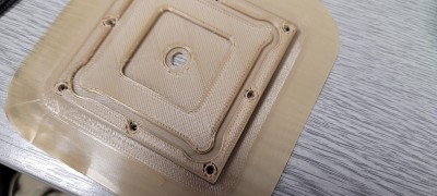

I have been having some issues with the walls and gaps. If I print with allow single extrusion fill, it stops the infill movement jittering like a couple of bunnies on their honeymoon night, and gets the wall extrusions to join together properly, but it can leave a gap in small areas. So, I change to allow gap fill, which sorts the gap, but stops the walls sticking to each other and brings back the jittering with the infill
It seems like I want both, but can't have both. I need the walls to adhere to each other, not jitter, and to fill gaps. Any ideas?

I would try the following:
1. increase the number of perimeters
2. enable external single extrusions
3. set internal thin walls to use gap-fill
More on handling thin features and walls on our site: https://www.simplify3d.com/support/arti ... -features/
