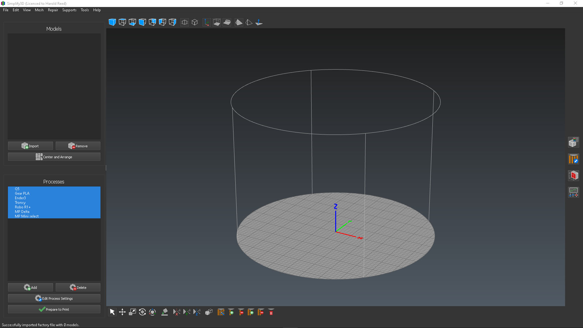

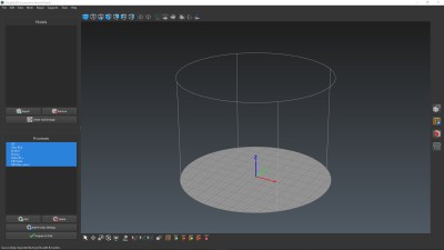

]When I select a Process in 4.1.2 it switches the build plate view to match the machine.
5.0.0 does not only NOT do this, but I have to select the process I want, close the program, reopen to get the visualization to come up, but it the program still autoselects ALL processes.

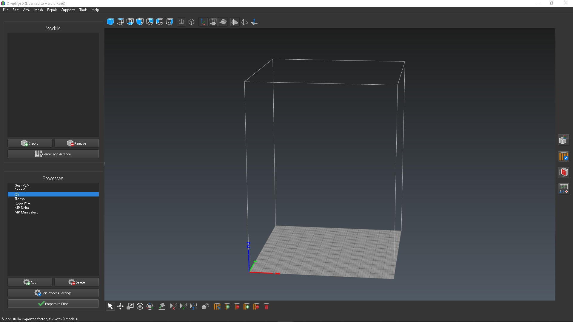

Even then I sometimes have to push the process I want to the top of the list to get the visualization to come up.

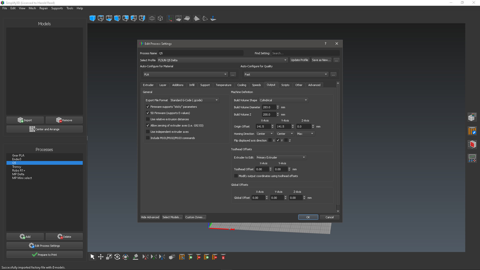

It looks like you have 5 or 6 different printer configurations being saved as different processes. Have you tried saving those as profiles instead? That way you would only need to have a single process in the UI instead of 6. It would also allow you to use all of the new profile management features that were added to V5. By having the printer settings as different processes it feels like it will go against the flow.
