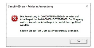

V5 Crash
The Program starts but after a few seconds it crash with a error Message that something happens with the RAM Adress.+
Windows 10 all Updates installed. V4.1.2 is working.

Open Windows Explorer and navigate to the following directory:
C:/Users/%USERNAME%/AppData/Local/Simplify3D/S3D-Software
You may need to enable hidden folders to access this directory. Once there, please try deleting the file called "savedState.factory". Then, open Simplify3D again.
worked for me.
Thanks!
Re: V5 Crash
Good to hear that deleting that file helped solve the problem. Any chance you have a copy of the problematic file that was there originally? Might help us understand what was causing this.
