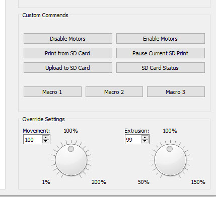

In V4 how there are the dials in the machine control window to adjust extrusion and movement on the fly.

Yes - where are those settings - I use them all the time!

I don't have any confirmation yet, but we are certainly interested in seeing how popular this request is to know if it should be included.
In the meantime, you can still adjust the flow rate using the Communication tab on the machine control panel. For example, to change the flow to 120% of normal just enter:
M221 S120
If you want to go back to nominal 100% flow enter:
M221 S100
