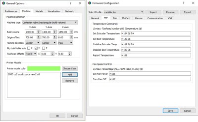

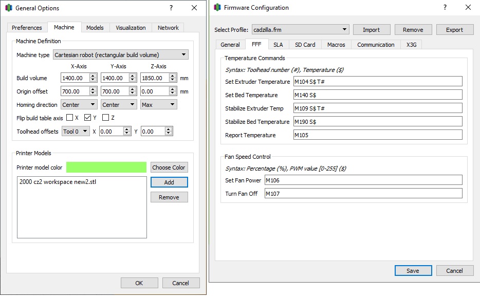

Ok so I am unable to modify the firmware settings now. as an example i use different M commands to turn on and off the fan.
I used to load a different .frm file for some of the machines.
Also are we able to load a machine model as before?
I dont understand why so many features have been removed.

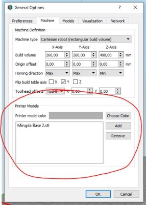

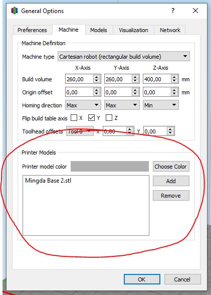

Uhm what?
In Simplify3D v4 we could just add the 3D machine model in the General Options windows, under Machine tab!
Why they removed this useful feature!?

I used to save a factory file as a master template for each printer.
It is the fastest way of loading all the corect settings.
All of the settings would then carry across. I could also switch the machine model/workspace on the fly. This way i can quickly update if i am using a different bed or table.
In one case we are using a very large table or plywood. This may be offset from the ground or in a specific orientation.
