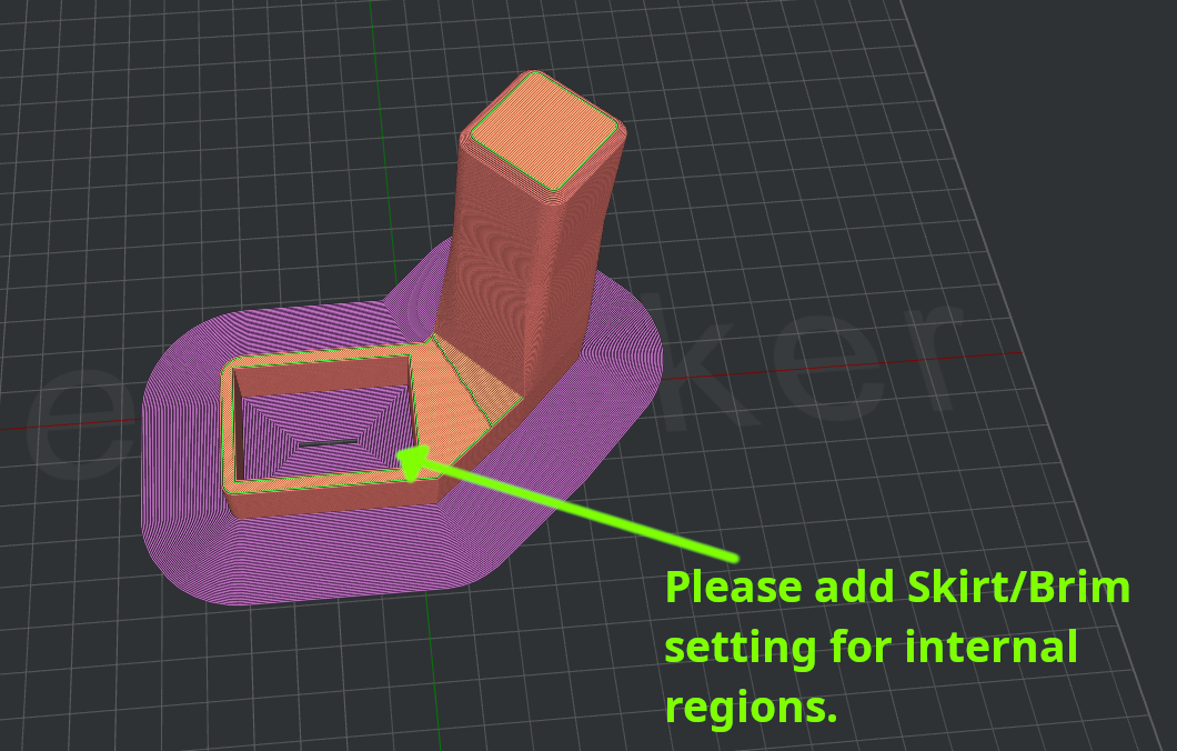

Please add Skirt/Brim setting for internal regions. (See Attached)
Re: Please add Skirt/Brim setting for internal regions. (See Attached)
Would a simple checkbox to enable the internal skirt/brim be enough? Or do you think it needs fully independent settings compared to the outer skirt/brim?
Preferably 3 states, internal, external and both. :)
I run into this problem when a part with a large internal opening then place a couple small part inside the opening. Those smaller inside the large opening don't get a brim. this might solve that issue. Have even tried 2 processes and still does not work
dibor wrote: Wed Jan 11, 2023 3:46 am Preferably 3 states, internal, external and both. :)
I vote for this. adding Brim would be nice and 3 states would be awesome
At the Moment when I am trying to add brim only to a part of the model its impossible to work the way it is (setting the distance for skirt to zero), because some parts are just to near and then S3D will do a skirt with distance
This is also important for my workflow. Variability between internal and exernal brim settings would be great but I'd be happy for a tick box just to have internal brims added.
I think this is a necessary feature.
inner, outer
If using an ooze shield, the brim gets added to the shield and not the part - so one for the ooze shield, model external, model internal would be lovely.
I have a model that requires an internal brim if I want to keep the exterior clean. This has been requested for almost a decade. PrusaSlicer has it, and after spending days tuning everything else up nicely in S3D, I will have to start over again in PrusaSlicer.
