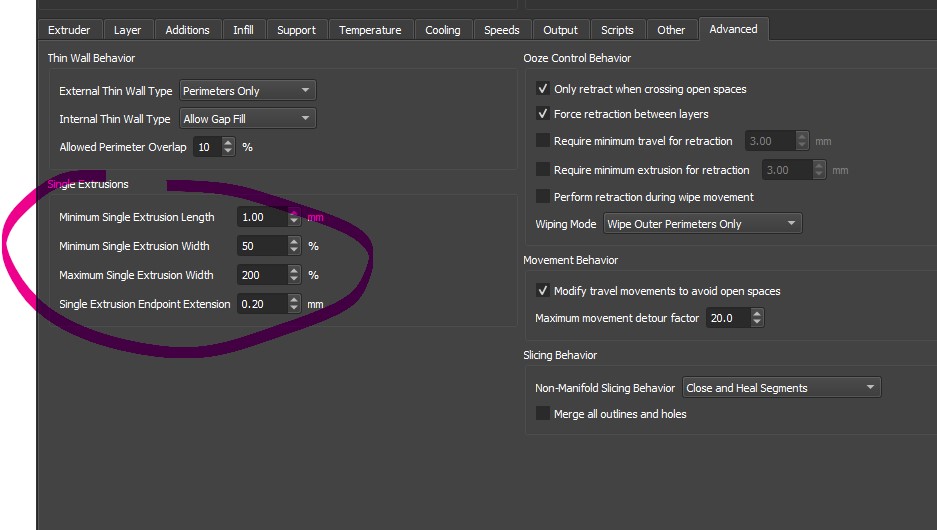

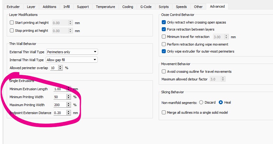

dsiegfried wrote: Arachne Perimeter Generator
This is actually where cura and slic3r are playing catchup, S3D had this in 4.0 (or 4.1) already many years before cura v5 and slic3r
in 4.1.2 go advanced and you see single extrusion section
in 5.0 it is in the same place
