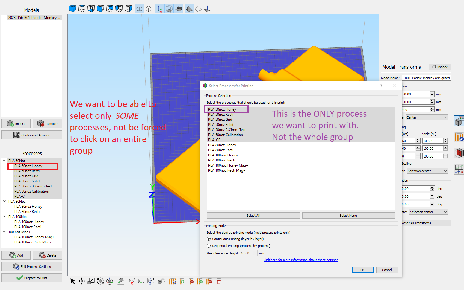

Posts: 39
Joined: Wed Jun 15, 2016 10:15 am
Re: [FIXED] All processes selected by default
S3D-Jason wrote: Version 5.0.1 was just released this week with updated behavior so that only the selected processes are used by default. This should match the old V4 behavior that was requested in this thread.
You can read about all the other changes at the link below:
https://www.simplify3d.com/products/sim ... ase-notes/
This is not fixed, and it does not behave like before. It was only half-way reverted. Please see screenshot below. We can still not use this software as-is.
process selection not fixed
Posts: 1413
The old V4 behavior was to use the same selected processes when the print dialog is shown. That's how it's currently working in 5.0.1 as well. If you want to suggest selecting a subset of the selected processes by default, I would suggest making a new feature request since that's a different behavior and we would want to see how many other users agree with the change.
