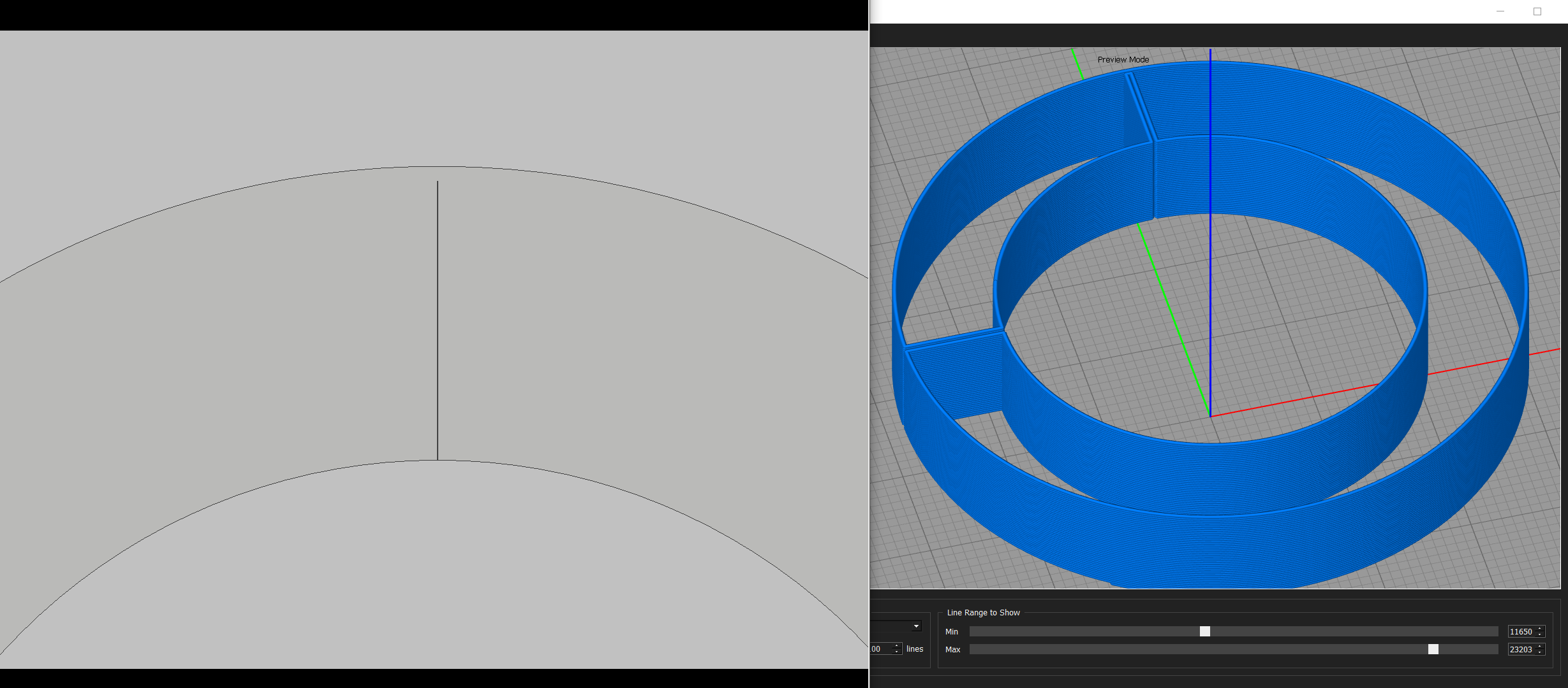

nerys wrote: YES this is vase mode compatible. JUST LOOK at where the red travel moves and retractions are. there is nothing THEIR for them to exist. just trust me its vase mode compatible.
Still you might want to check the model file again. Some parts aren't properly seperated from the
outer shell, causing additional loops.
In other places there's too much seperation, causing closed perimeter loops:

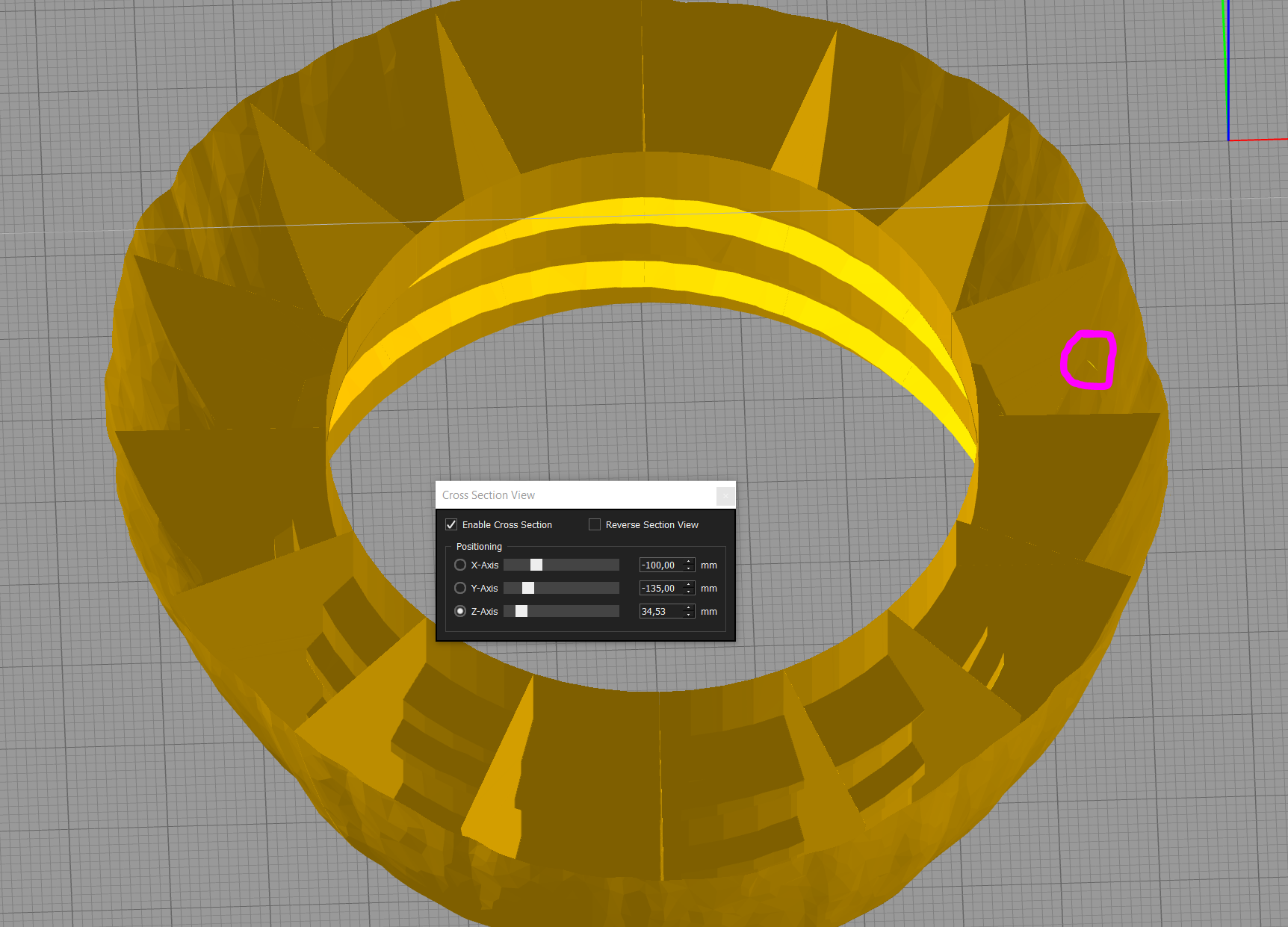

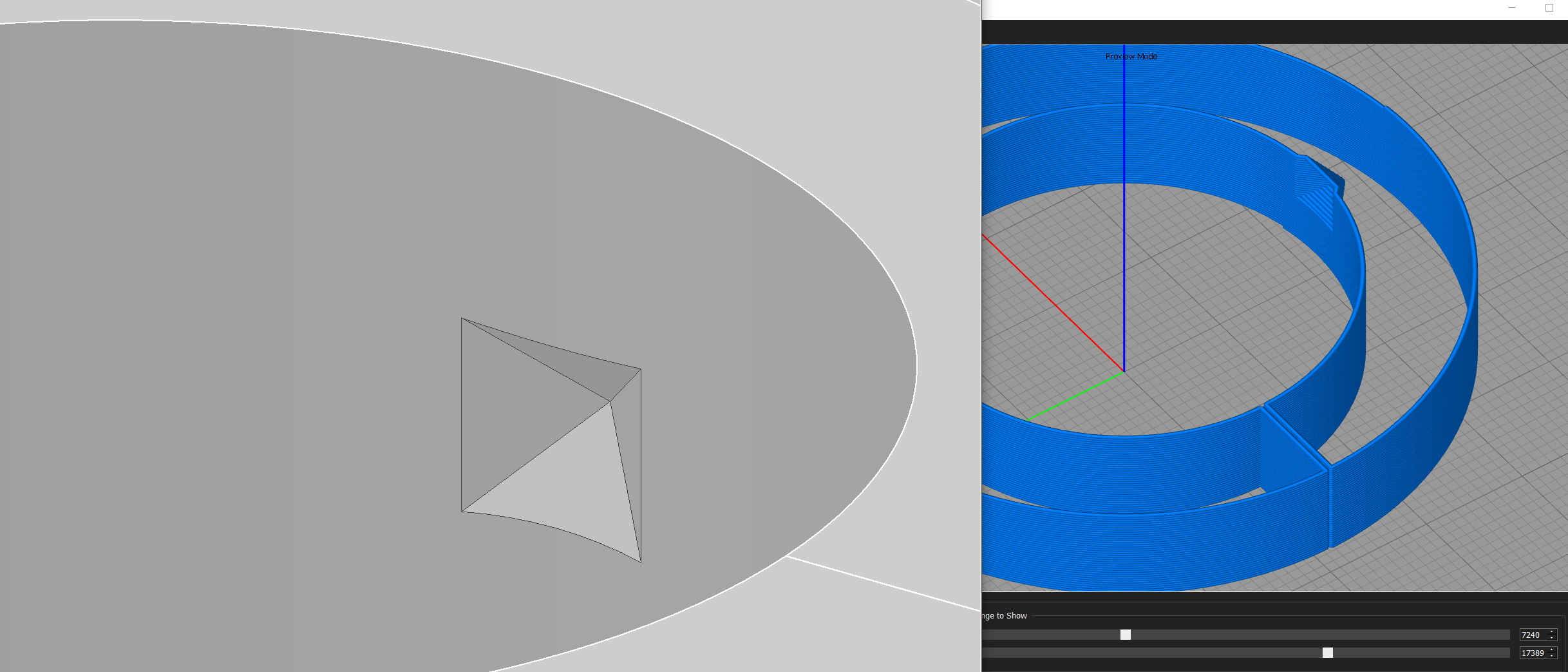

There's actually some intersections in the model... don't know why NetFab et al don't get triggered properly by
this, but this would explain why I can't get this sliced in vase mode in any slicer...
cross section in S3D, at some points at certain angles tiny lines pop out from the surrounding:
And a closer look at the mesh, inside:
...and outside:
(note the white lines which "disappear" shortly after the vertices, they're "overlapping" with another face, creating
a tiny downward crease and breaking vase mode compatibility)
Would love to see how this was sliced in vase mode in PS...
