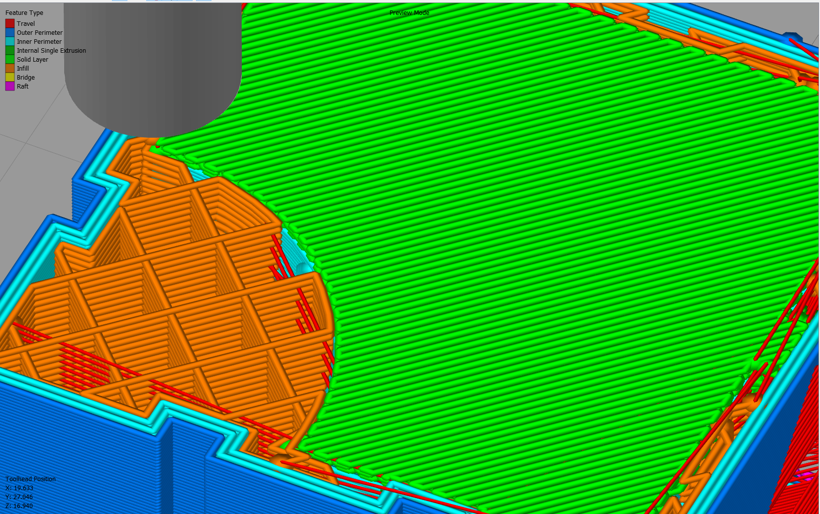

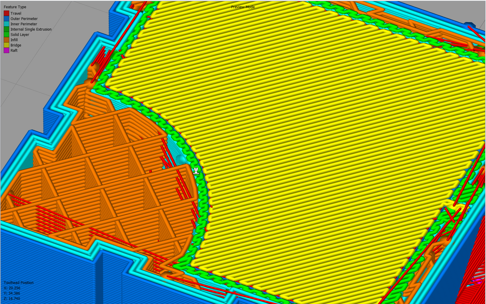

OK. not a huge deal. 50/50 it works ok. but it would work so much better if it did this correctly.
When it comes to bridging. it does something dumb. it does this.
When it should be doing this (note I could not make it do this. this is 2 layers up but this SHOULD be what the first bridge layer looks like)
it should be bridging over all 3 perimeters so it "adheres" more reliably.
instead of does this dumb "squiggle" zone over the first to perimeters and THEN bridges only using the last perimeter. why bother recognizing you can use all 3 perms to bridge and then just waste it doing this?
Is there anyway to make it do this right? Factory attached. yes I tried with include perimeters on and off does not appear to make any difference.... am I using it wrong?

Using the factory file that you'd provided, this is what happens when the Identify Bridging Regions is turned OFF.

adjust the bridge extra infill expansion should get right of the green as it will grow into it.

...... It works better turned off?....... Wow
DrD wrote: ↑Thu Apr 20, 2023 10:14 pm Using the factory file that you'd provided, this is what happens when the Identify Bridging Regions is turned OFF.

Interesting that's not how I would have interpreted that function works I will have to play around with that thank you
gearsawe wrote: ↑Sun Apr 23, 2023 9:15 pm adjust the bridge extra infill expansion should get right of the green as it will grow into it.
