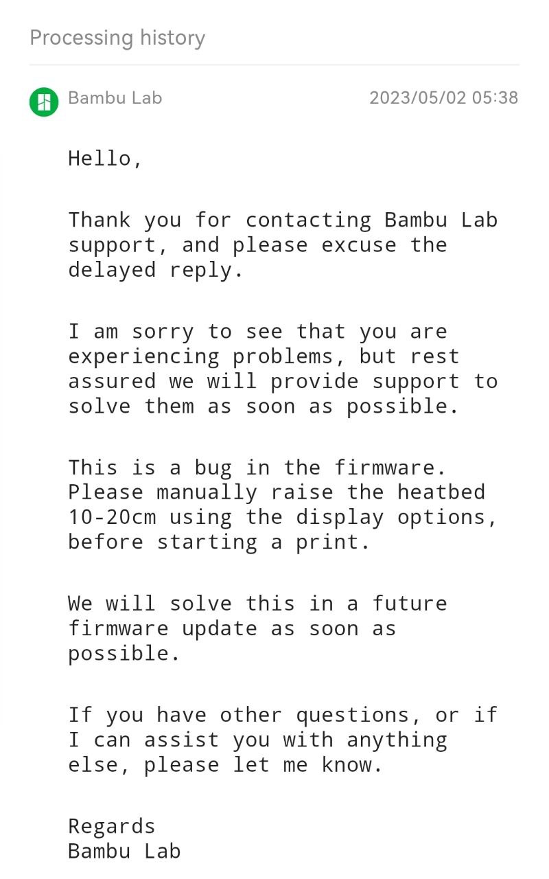

My ticket is still in progress and for some reason I can't copy the text to paste it here, but here was their last reply.
