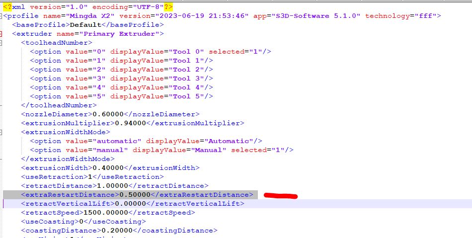

nerys wrote: ↑Tue Jun 20, 2023 11:06 pm I figure there has to be some simple setting I am missing? why would it NOT retract in infill?
nerys wrote: it won't "retract" during those travel moves. I am not sure why.
I didn't upgrade to v5, so I can't open the factory file and look at it inside S3D. But you might want to double check your
retraction settings. Guessing from the XML files you're not having a problem when retracting, you're having problems
after the travel move, when plastic starts to flow again.
Process #2 is set to a extraRestartDistance of 0.5mm (!)
Using a 0.4mm extrusionWidth and 0.3mm layerHeight that's roughly the amount of material extruded it'd take for
a ~10mm perimeter just right after the travel move...
