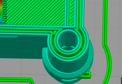

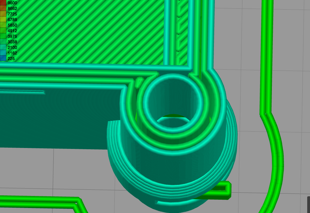

ahhhh, something is up and the feature is not being activated for me. i loaded up a model with thin walls and no matter what % i have that feature on it still leaves a gap. i have tried all the way up to the max 50%. i can even reduce my extrusion width down to make the gap bigger to where its clearly larger than one line width and still nothing. not sure whats going on there.

jimc wrote:ahhhh, something is up and the feature is not being activated for me. i loaded up a model with thin walls and no matter what % i have that feature on it still leaves a gap. i have tried all the way up to the max 50%. i can even reduce my extrusion width down to make the gap bigger to where its clearly larger than one line width and still nothing. not sure whats going on there.
keep the gap fill to 50%, but also increase your outline overlap to something like 50% as well
