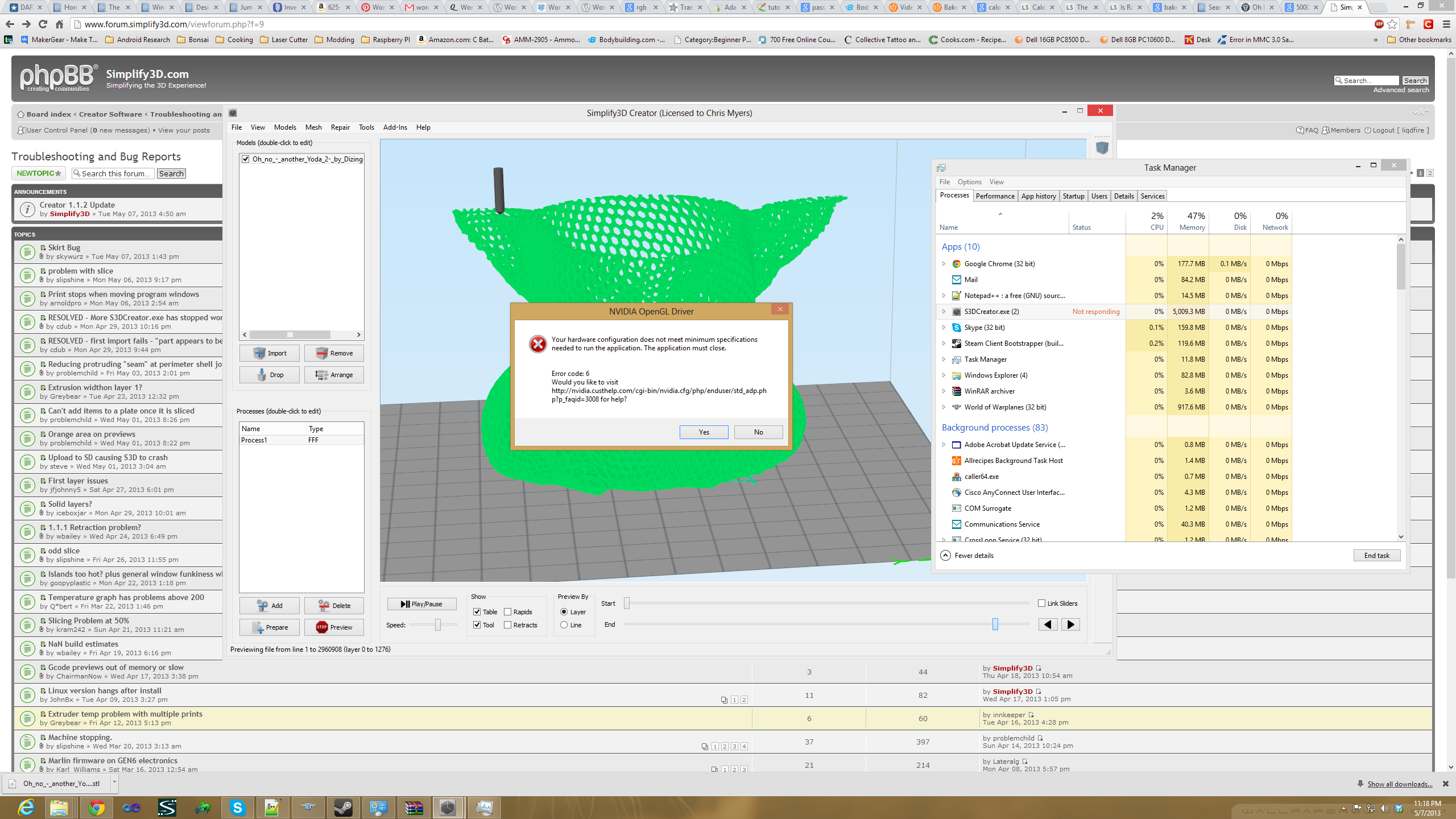

Crash in Middle of previewing
I am running the new 1.1.2 64 bit version and it crashed when previewing a slice of http://www.thingiverse.com/thing:85656
The gcode file was 85 Megs slices with a .1mm resolution, I can upload to my webserver if you want to download the actual gcode I was previewing.
I am running a Core I7 3770K with 32gigs of Ram, I do have a slightly older video card though Nvidia GTX 260.
s3d Crash.png (626.37 KiB) Viewed 2856 times

try Tools, Options, low detail to reduce the memory.
Also, make sure you have the latest Nvidia driver for your card.
Both helped me.
