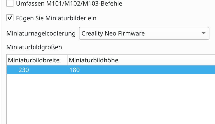

Under Cura I can show thumbnails in the display.
In S3D I have made these settings, but no preview is displayed.
My printers are the Ender 3 v2 and v2 neo.
Am I doing something wrong or is this not working with my printers?
Posts: 1609
Re: Thumbnails in display
You have to use very specific encodings and thumbnail sizes for the image to display. We already released a profile for the Ender 3 V2 that should work without any changes. Go to Help > Configuration Assistant, type in "Ender 3 V2 Neo" and then download that profile. We have tested this with our own V2 Neo and it displays the thumbnails correctly.

Thank you very much.
That worked.
