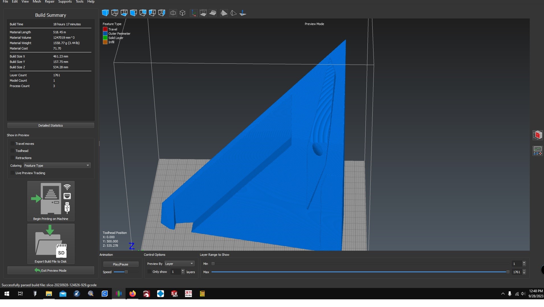

So i have noticed with v5.1.2 that i get these random Bridge layers in between layers of infill. Solid diaphragms are turned OFF. Typically rotating the model a few degrees or even repositioning the model on the build plate will either eliminate the random solid bridge layer, increase the quantity of them or decrease the quantity of them. It happens with multiple models and seems more prevalent when I have multiple process' for a single model. The larger the model the more likely they are to show up.
Here is the model with it centered and aligned to the build plate using the auto functions in S3D. you can see the single solid bridge layer.

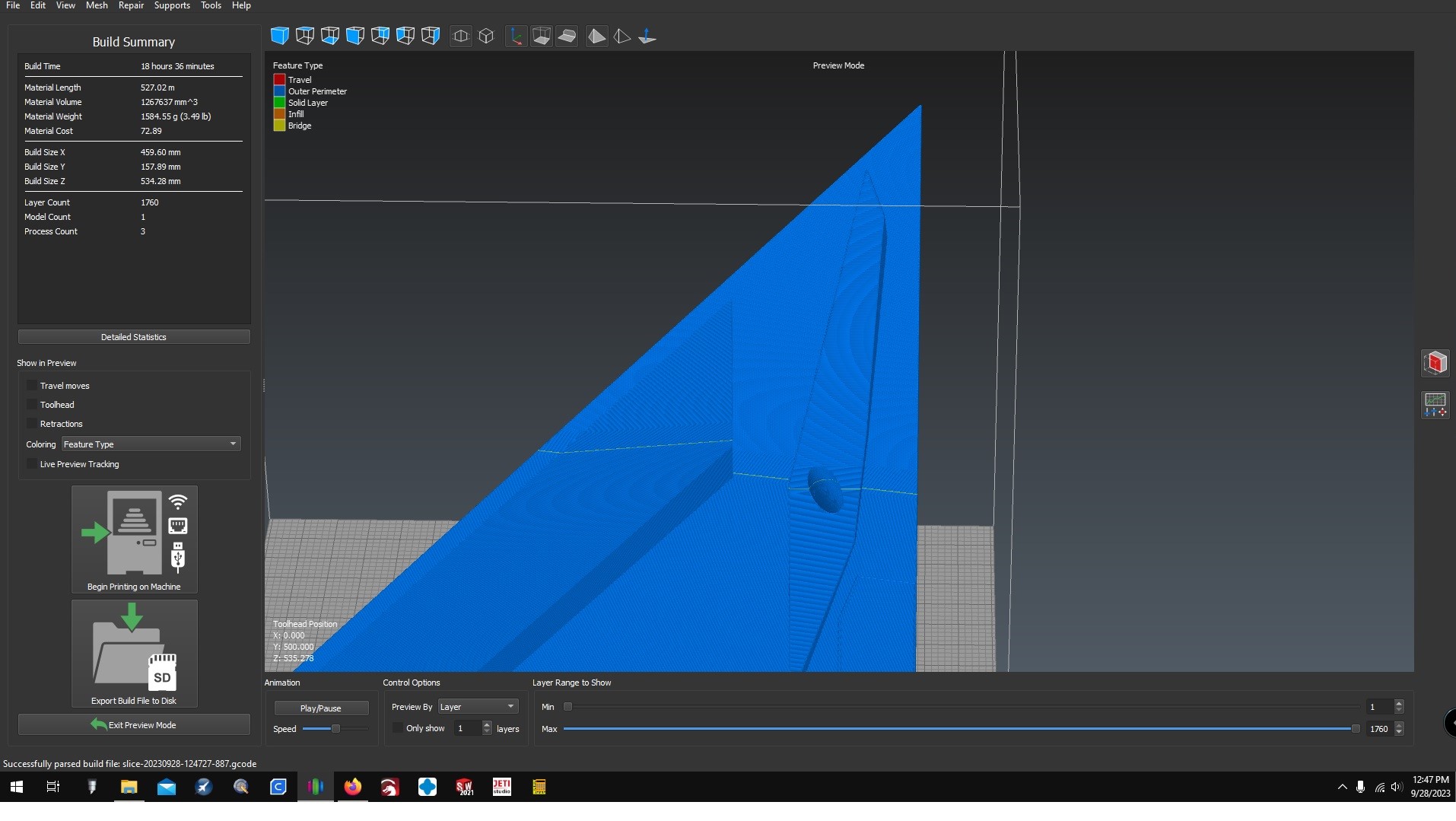

The same model as above, only rotated 3 degree's and the solid bridge layer has disappeared. With this model, if you do not rotate it and move it fore or aft on the build plate, it will increase the number of solid bridge layers within the model.

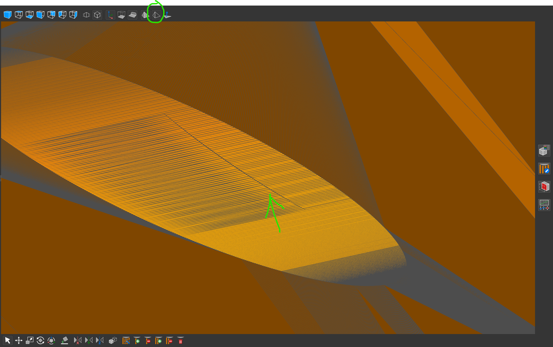

Hi, click on "Display the Wireframe Edges for Each Triangle" Then you can see that there are a mistake in the part, small crack in the hole. The problem also occurs in this area.
I can't tell you why the Slicing problem is solved by turning the part.
