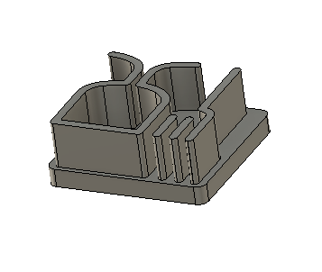

When I try to print a small part it gets cloggy. The same part was fine before last version of Simplify3d.
DISK 360.png (23.21 KiB) Viewed 2261 times

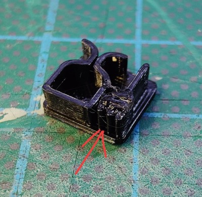

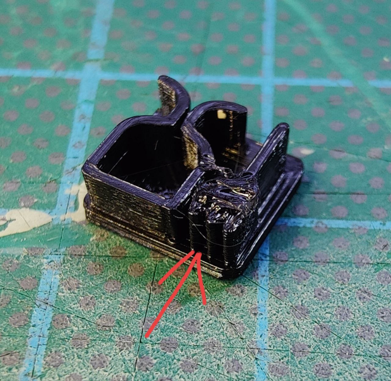

Why is this happening?
Re: Blurry small parts
If you compare the new gcode file preview with the one you printed previously, do you see any changes? You could try setting the preview mode to Movement Speed or Flow Rate to see if that helps you spot any settings changes that might be responsible for the different quality.
