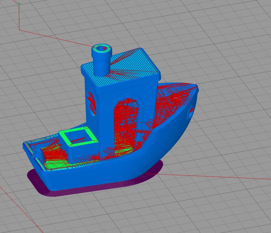

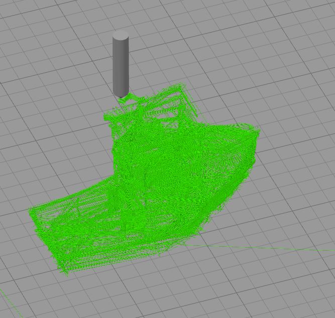

Almost had a fun bug to add. I will simply reference it here since in prep to post the bug, it promptly ran away.
Created a copy of the file, and restarted S3D to be sure everything was reproducible.
I had previously gone in and out of the print mode and gotten the same results, several times. Fortunately, no crash.
Since this green thread issue might be related to the no error crash above, I think this might be a great place to post.
After making a copy of the factory file, and renaming the file to submit, now it no longer acts up.
So this screen shot is as good as it gets. Yes, this ONLY shows moves, I am reasonably sure, and it's not a setting. This happened after setting infill to 75% on fast honeycomb. 20 was fine and 100 was fine. But at 75%, I got green string.
Fresh instance of S3D v5120 with the copied file, the same exact setup, no green string.
I really want to make both of these images side by side but have no idea how to make that happen.
Green Silly string effect at 50-55 mm/s without any actual printing showed. All preview checked off an exposed.
Same exact settings as below. Fresh restart of program on copy of file. Color of string is different and object is now shown correctly.
