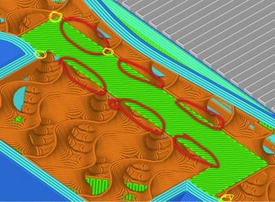

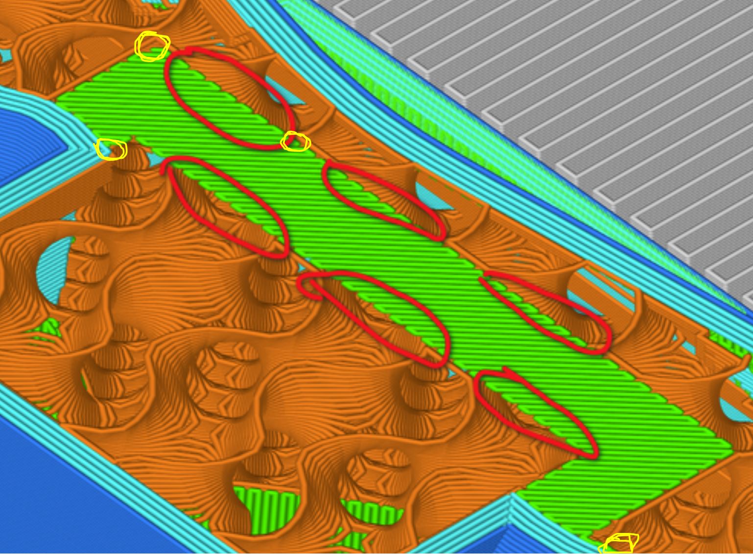

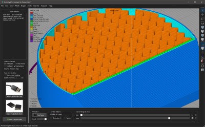

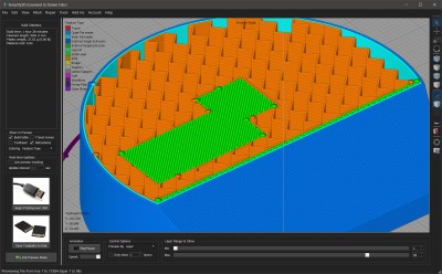

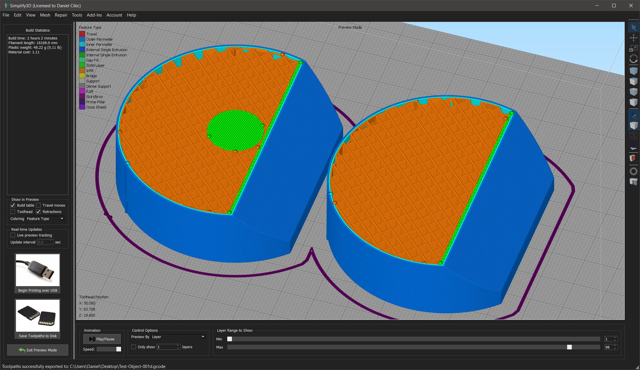

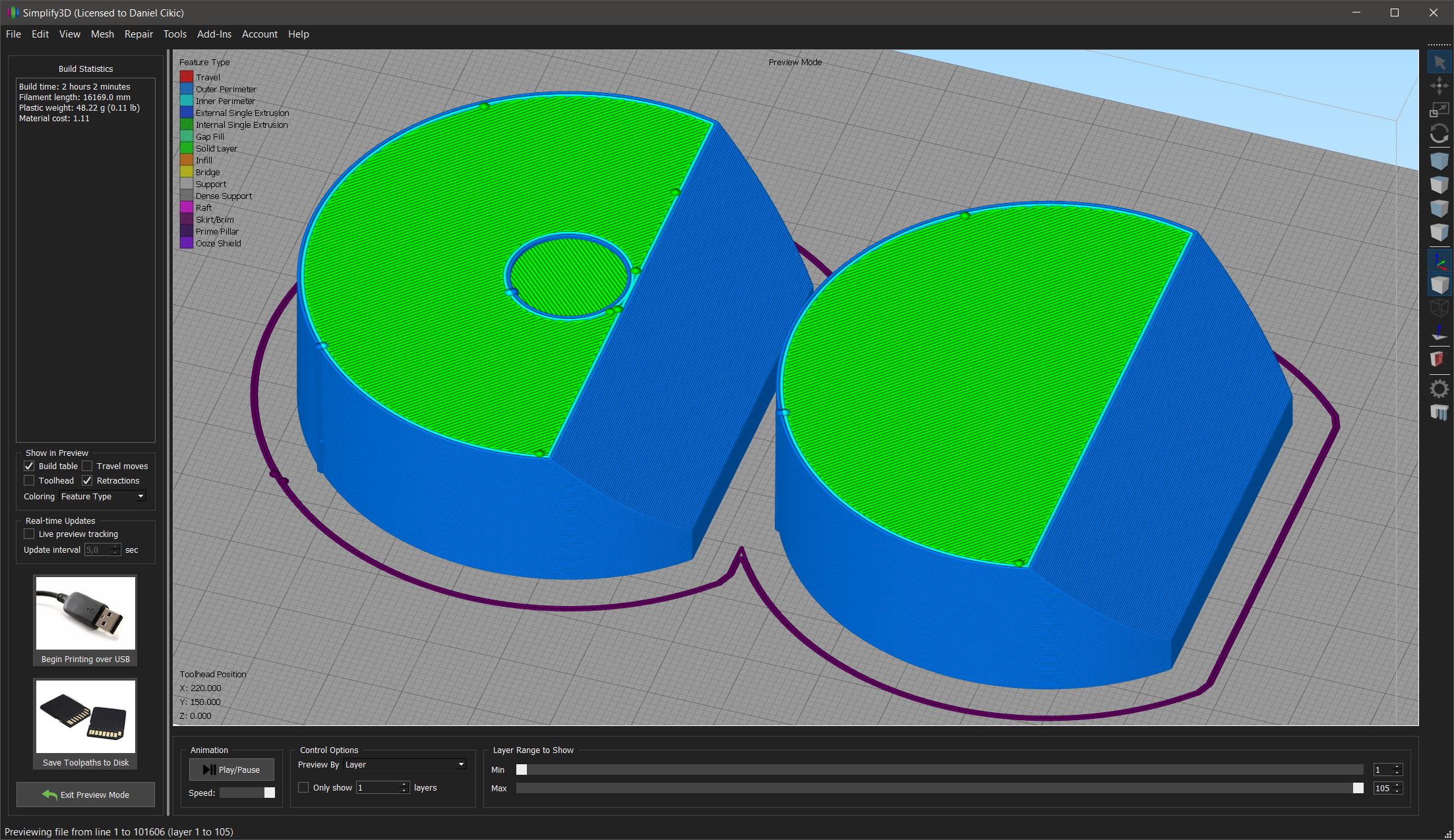

This is definitelly not how the slicer should work. I have still the same problem everytime and this should not be the behavior of slicer. If i have infill and next layer is coming it should make a full layer, not stopping in the air.
It just f.cked up 20 hour print so thank you

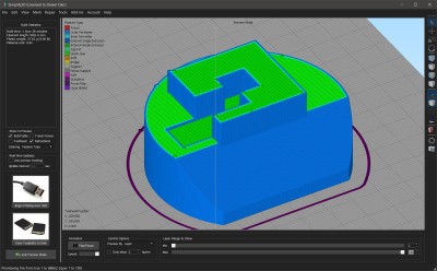

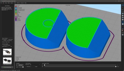

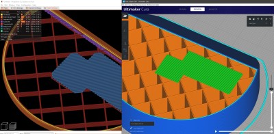

It's impossible to say how that layer should look without knowing what the rest of the object is supposed to look like.
Example like yours:
And that's perfectly fine here. Because that area isn't as high as the surrounding ones later on:

I am not sure if you understand that situation correctly. The first layer on the infill is printing without start and finish point on the infill so it starts and finishes in the air so it just stays on the nozzle and you "pull it with it back".

Then maybe you can clarify a few things, so people can understand what your post is actually about, especially in combination with
Nobody can tell by the pictures provided how the object is supposed to look like after layer 306. So why do you want it to
"should make a full layer", is there actually a flat surface coming or is there an indent like in my example?
And why aren't the start/end points circled in red, what are those areas supposed to tell if it's about start/end points?
Start/endpoints (yellow) should all be anchored on the outer perimeters or the additional "frame" generated by the infill, depending
on infill overlap settings. Cura for example would require skin count > 0 to create this inside the infill.
If you are worried about the red circled parts (which are continuous extrusions, not start/end points), that's a result of the selected
infill pattern, percentage and infill angle. Looking at the picture the easiest answer to this would be:
You're printing using a too low infill percentage, not providing enough support for solid areas.
Do you happen to know of a single slicer out there that does automatically adjust infill to support solid layers from edge to edge(!)
everywhere? Would be interesting to see, I didn't come across one yet...

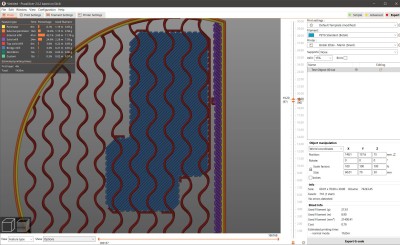

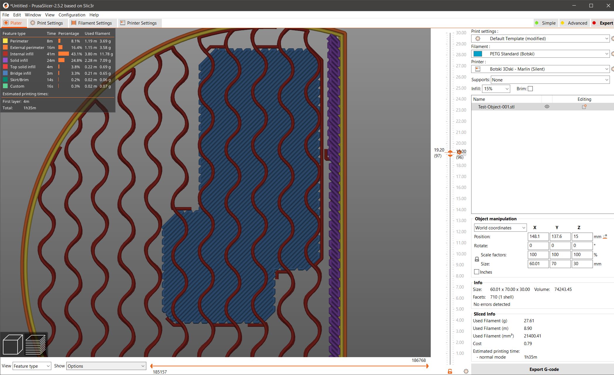

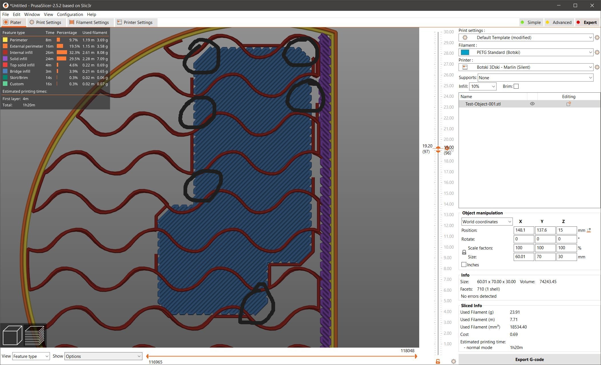

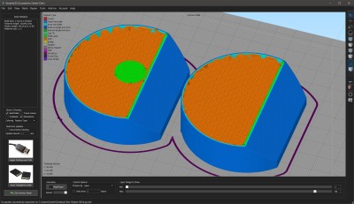

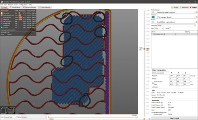

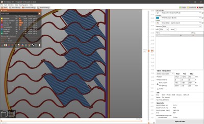

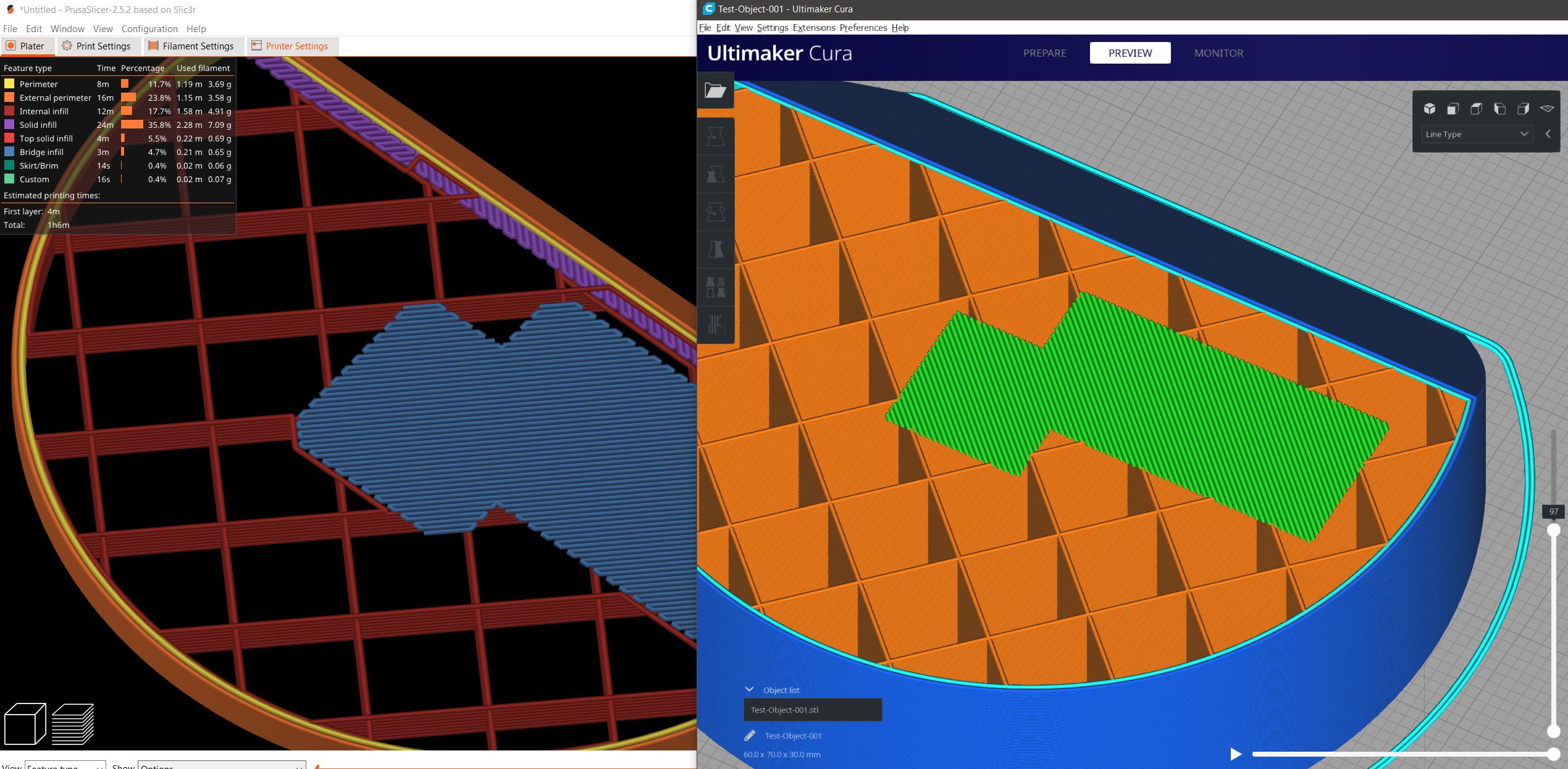

Not running S3Dv5, therefore no Gyroid infill. Here's screens from PrusaSlicer:
If what you're worried about is indeed the red circled areas in your picture and not the start/finish points, this is what the
problem looks like from below in PS:
If you don't want parts of the infill to hang mid air, adjust infill percentage, alignment and/or pattern to minimize those areas:
Or use the solid diaphragm option to create solid layers exactly where you like them. Or different processes.
Additionally setting up bridging parameters for those areas might also improve results.

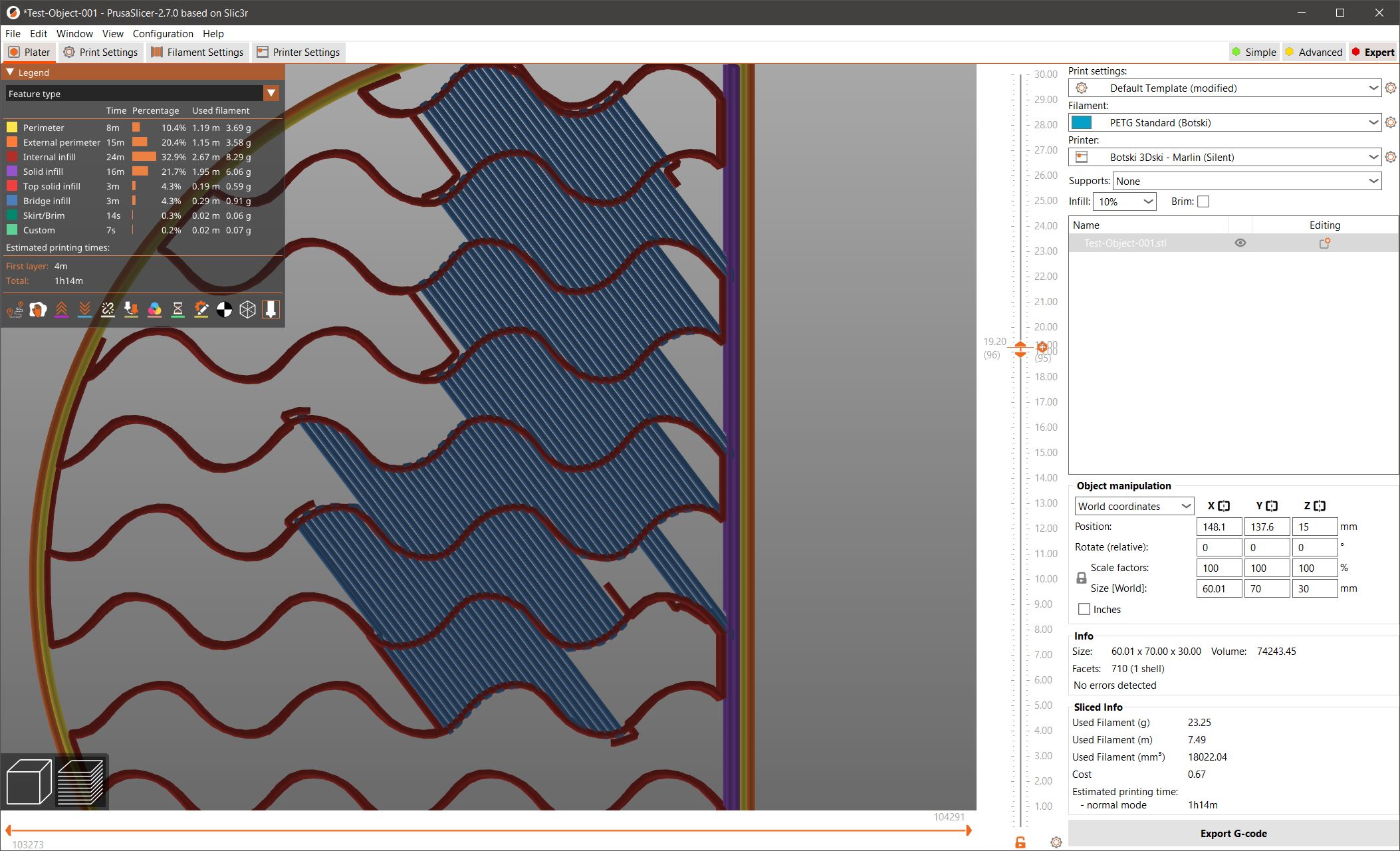

Updated PS, the "Extend Sparse Infill" feature seems much more sensible in these cases than whole solid layers...

parallyze wrote: Fri Dec 08, 2023 8:46 pm Edit:

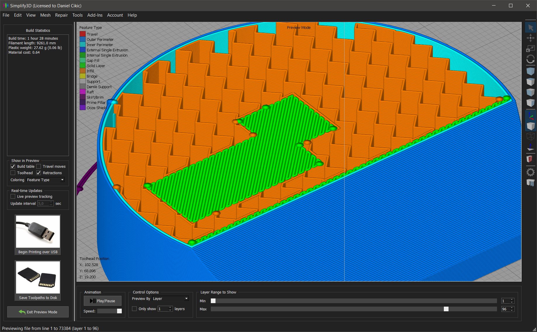

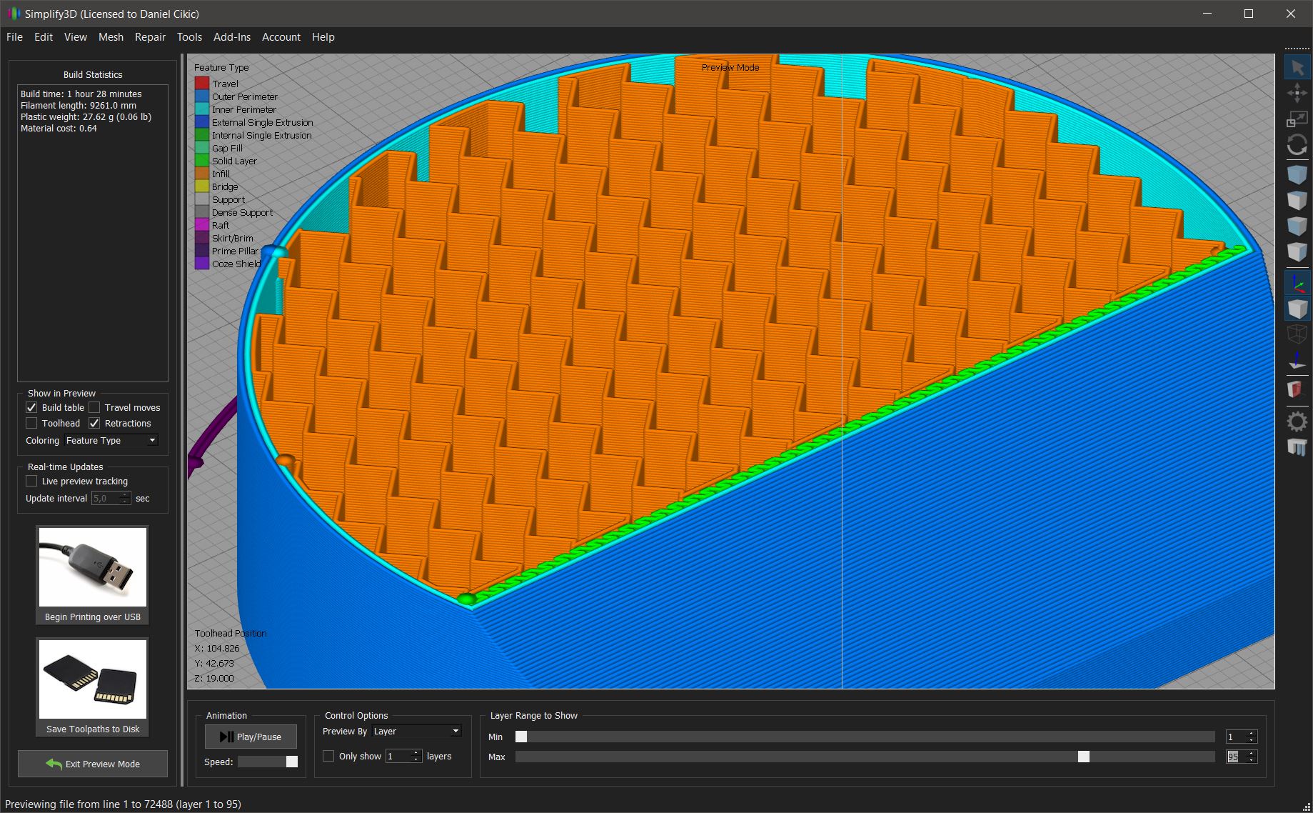

This!!! This is it! This is how it should be. That layer just can not be in the air on the erge. It should be connected to infill wall so it sticks on the place. So Simplify3D is waste of my money once again :|

Sorry, but i really do not know how to tell in other way. I think that this is more clear than it could be. It doesnt matter what layers are above those i am dealing with and if you think that it is important, you do not understand the problem.

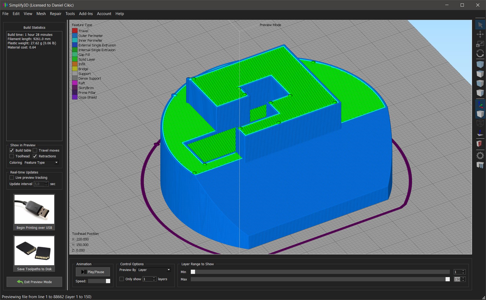

This is why following layers ARE important to judge the current layer:
Note the indent on the left object.
The area under the indent is lower, therefore solid infill has to start earlier to stay within the configured amount
of solid top layers.
And asking for a feature like "Extending Sparse Infill" is different from "should make full layer". Because if that was done
above example would end up with 6 top layers around the indent instead of the configured 5.
