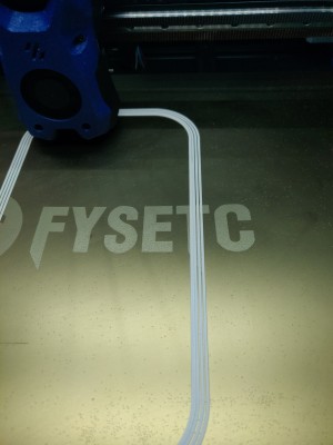

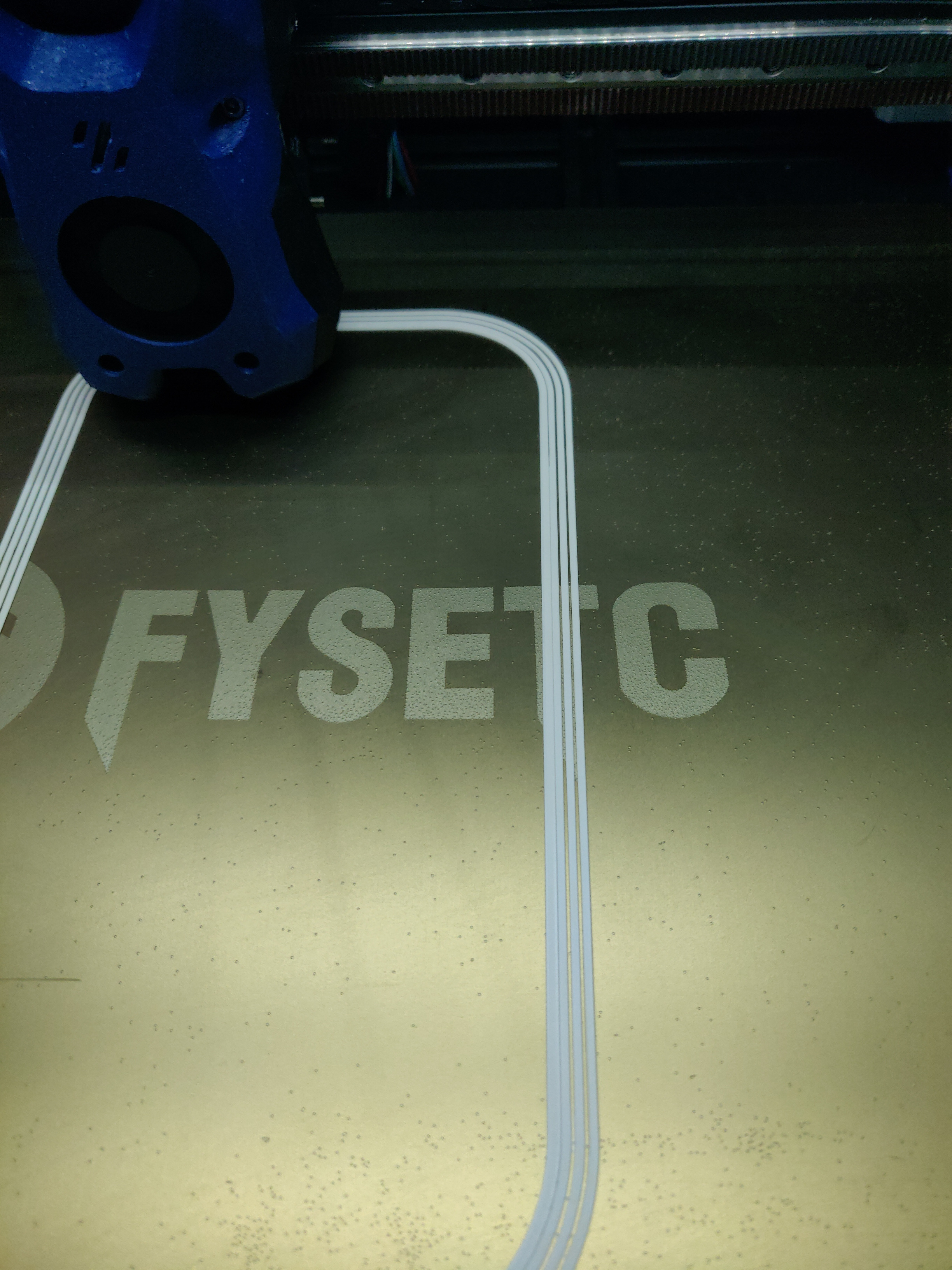

I'm trying to print a canopy for a model. It's fairly large, so tries to lift during the print. I figured I could fix that with a brim, but the brim outlines dont touch except for the one closest to the part barely touches.
I'm using a 1mm nozzle, 1.4mm extrusion width, 150% first layer width, 80% first layer height ( .25mm later height ).
Playing with the settings, I find they generally don't change things.
What am I missing?
parallyze
Posts: 372
Re: Gaps in brim
joel wrote: Wed Dec 27, 2023 3:29 pm 80% first layer height ( .25mm later height ).
What am I missing?
Maybe you've missed one of the changes a few years back, I think introduced in v4.x.
Reducing first layer height will now also reduce the amount of material extruded. Up to
v3.x this did not happen, so lowering first layer height simply was some kind of z offset.
Edit:
viewtopic.php?p=47772#p47772
