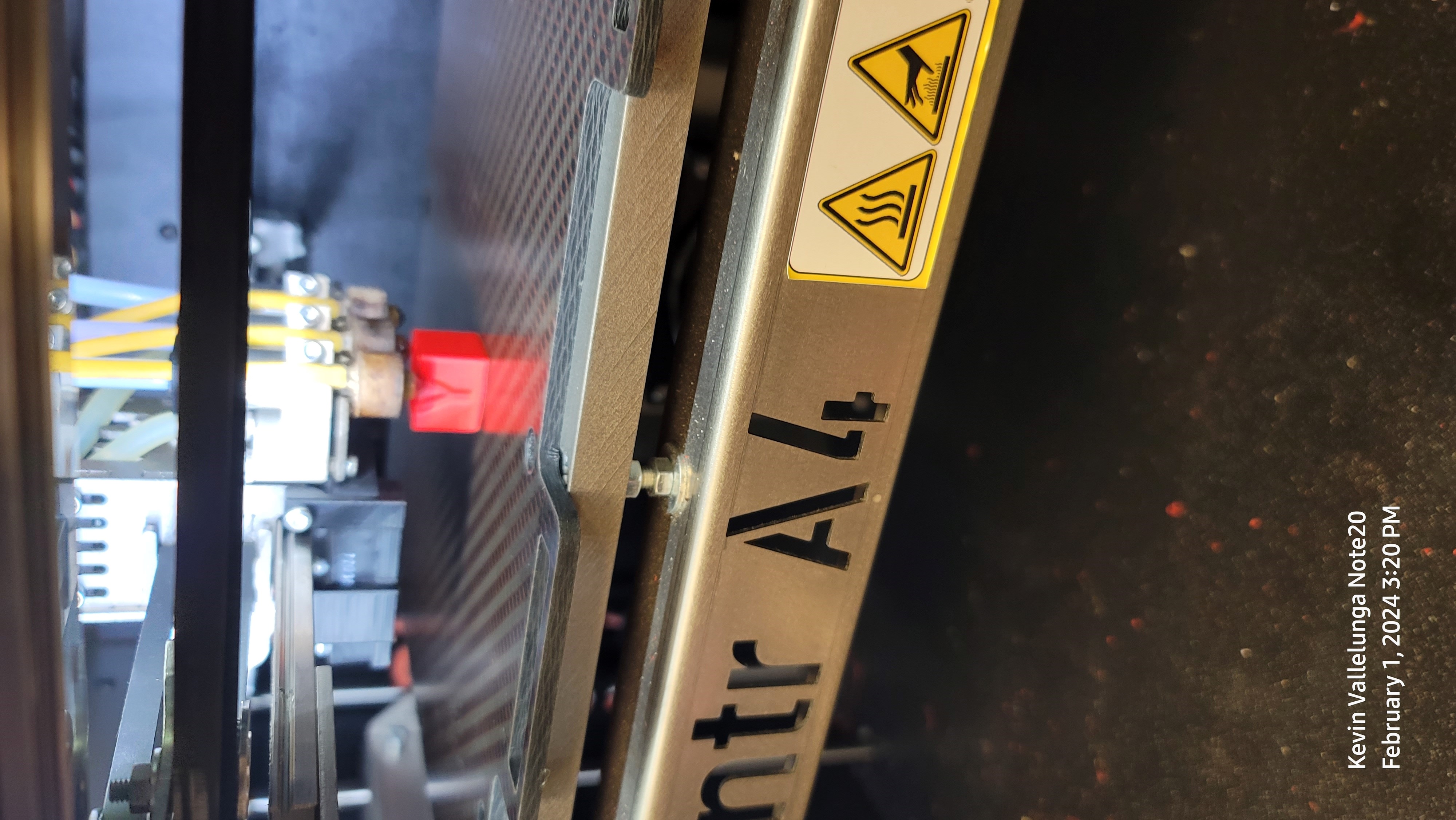

Jason thanks for your help, we were up and running within 15 minutes! We do have a slight problem with material, on our first layer it didn't start extruding until about 30% into the first layer. We did have a new roll that is dry and the nozzle was purged. Is there a setting that controls how much material is over-extruded at the beginning of the print?
Sorry about the orientation I didn't take it that way.
