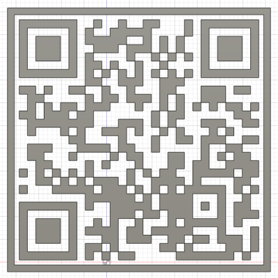

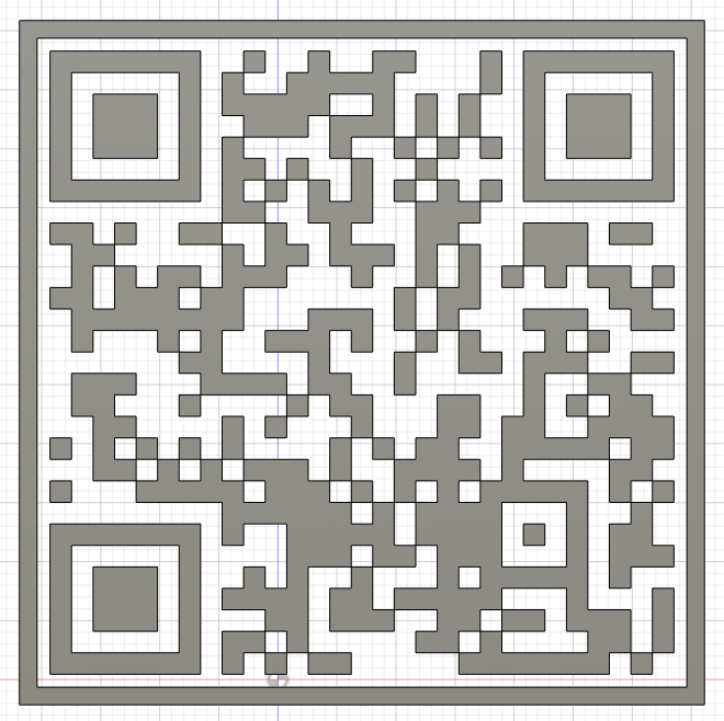

Original from Fusion360:

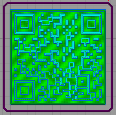

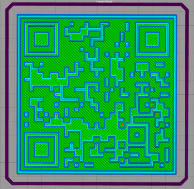

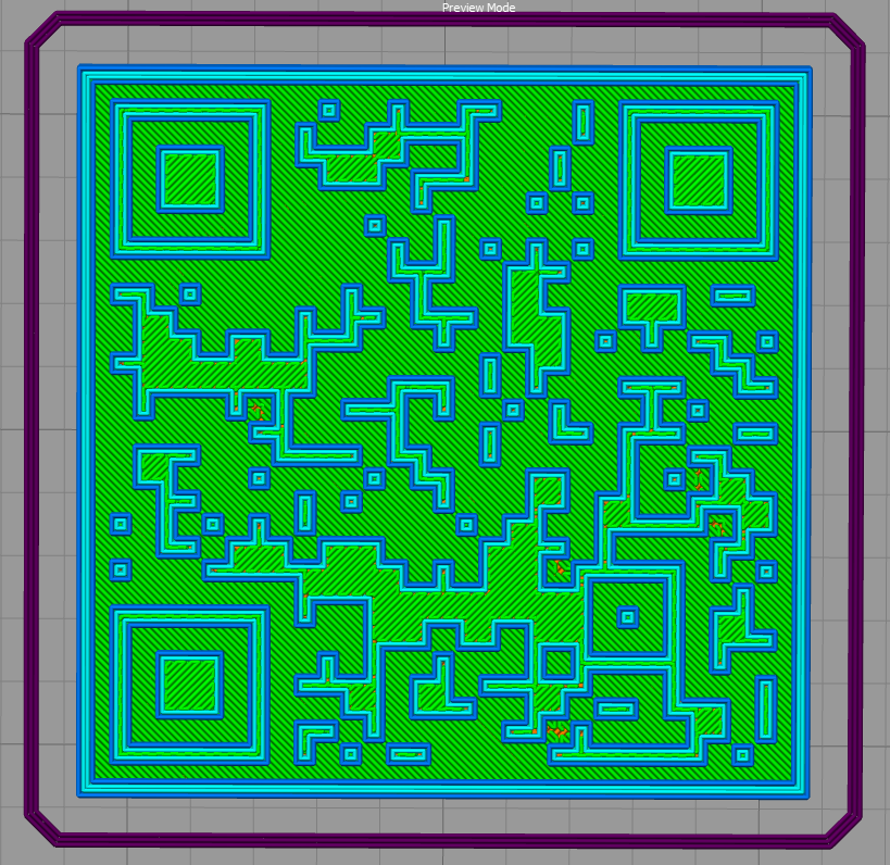

This is what Simplify3d_V5.1.2 makes of it:

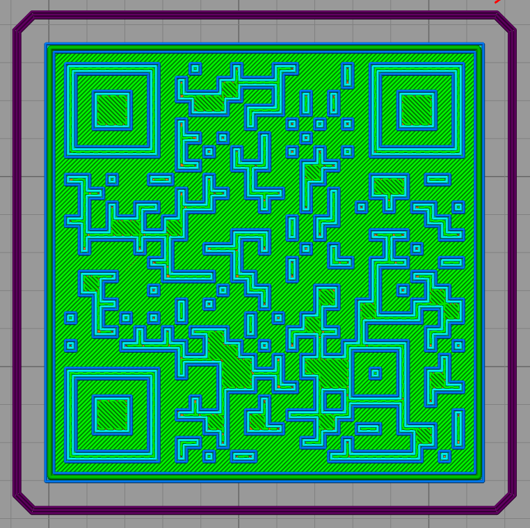

With Simplify3d_V4.1.2 the QR-Code is displayed correctly:
What could be the reason, what am I doing wrong or is it a known bug.

Re: QR-Code is not displayed correctly
Have you already tried the things listed on this page?
https://www.simplify3d.com/resources/ar ... sh-errors/
A lot of those suggestions help with slicing or mesh issues. In particular, try going to Edit Process Settings > Advanced > and set the Slicing Region Repair Mode to "Alternating Fill".

Many thanks for the quick reply.
The QR code is now displayed correctly.
That was exactly the right switch.
