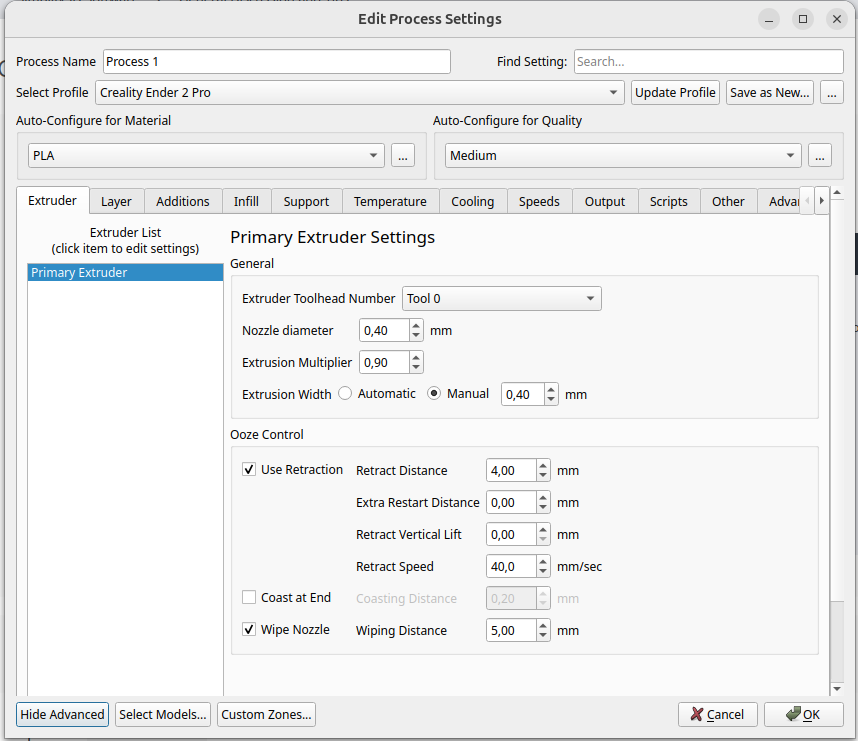

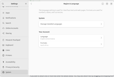

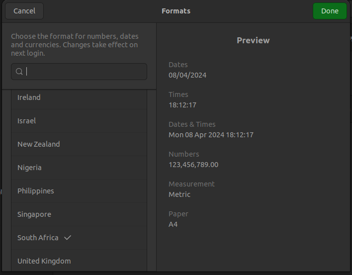

A few months back I moved over to Linux as my daily driver on my personal laptop, where I have S3D installed. But I have been unable to figure out where S3D is getting the number format from for the settings menu. All my settings in Ubuntu are set to South Africa, and when I check the language and region it shows my numbers correctly
But when I open up S3D, the settings and pertaining numbers don't adopt this format
Not sure what I'm missing, but I forget this is the issue often enough to get irritated, and have tried searching the forums and haven't come across anything to guide me where to change this setting in Linux.
Ubuntu version is 22.04.4LTS with the latest updates
64bit installation
Gnome version is 42.9
X11 on the windowing system.
Thanks in advance

On windows it works off the region settings, but no quite sure why it isn't working with the linux version. I have tried a few language and region settings, but nothing seems to help. Later on I'll look at uninstalling the app then re-installing. It could be my install of ubuntu that is the issue, I noticed yesterday evening that all my desktop icons suddenly disappeared, though they are in the desktop folder. So I'm leaning towards that being the issue rather than simplify. Probably only get around to formatting this weekend. But will feedback if it sorts it out or not.

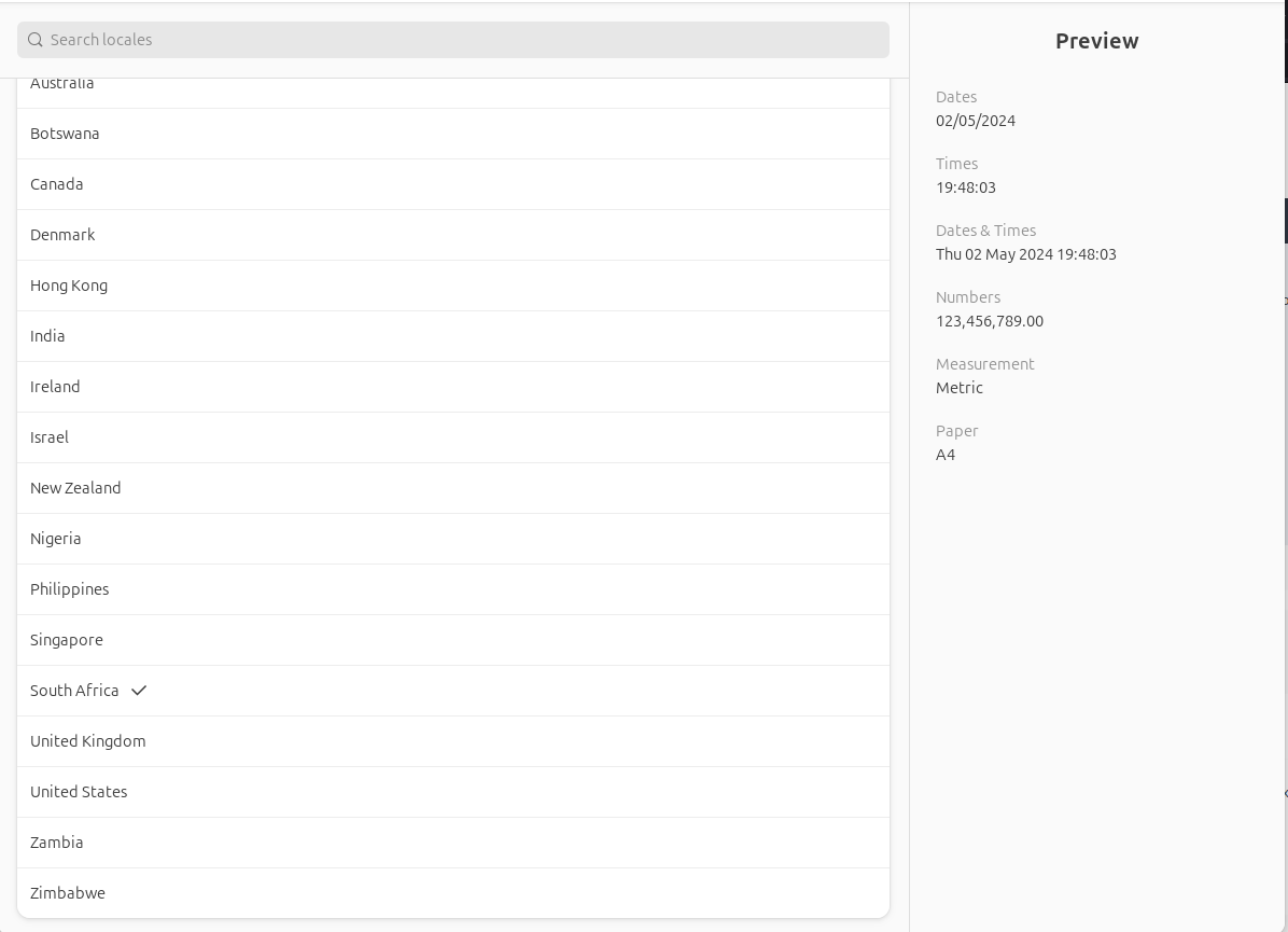

Yes that is correct. I have a fresh install now, running the latest version of Ubuntu LTS and same thing hey, my location is set to English South Africa, and language is set to English US, if that makes a difference. Just finished installing Simplify and location and language were setup during install.
Could it perhaps not be using the number separator opposed to the decimal point?

What happens if you change your location setting to US? It may be based on location and not language.
shauncro
Joined: Sun Jul 02, 2023 2:40 am
Re: Change number format to decimal place instead of comma
strangely, that worked. And it's still in metric and hasn't changed to imperial. I did try that in 22.04 but that install was a bit messed, so didn't take I guess.
It did how ever reset my profile back to default, luckily that's quick to fix all my settings. Last os crashed earlier and didn't have a chance to export my profiles, but not a train smash.
