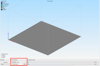

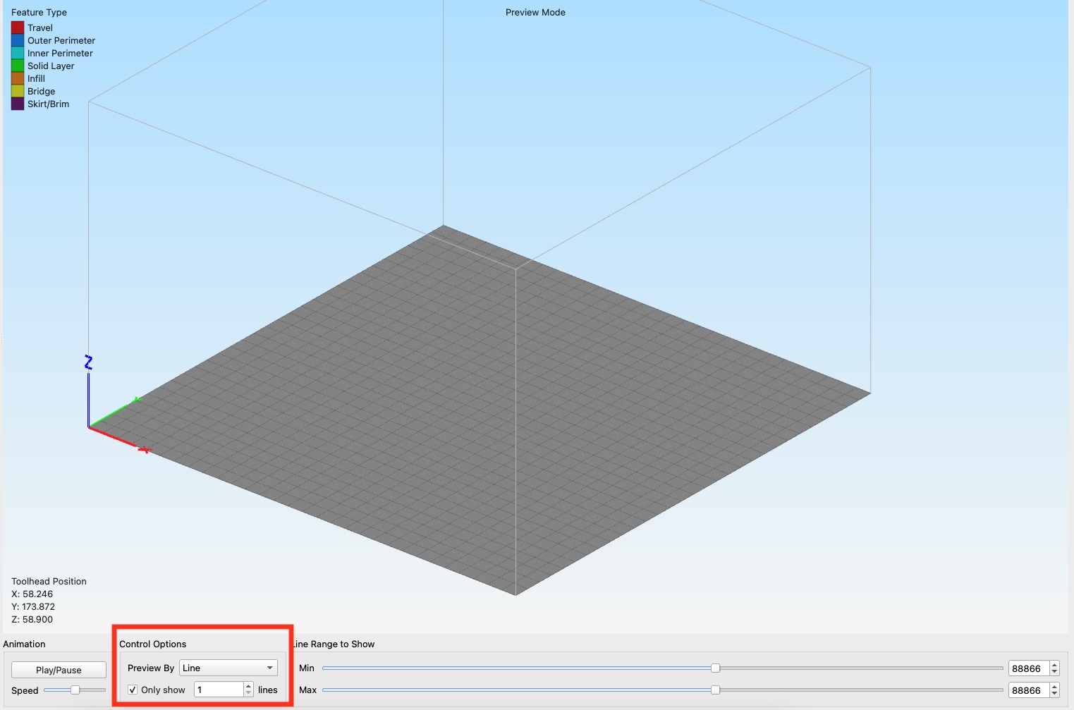

I was able to slice and preview the file without any issues. Did you perhaps turn on Preview by Line and checked 'Only show 1 line' by any chance? (see screenshot)
If not, please attach a factory file so I can take a look at it instead.
