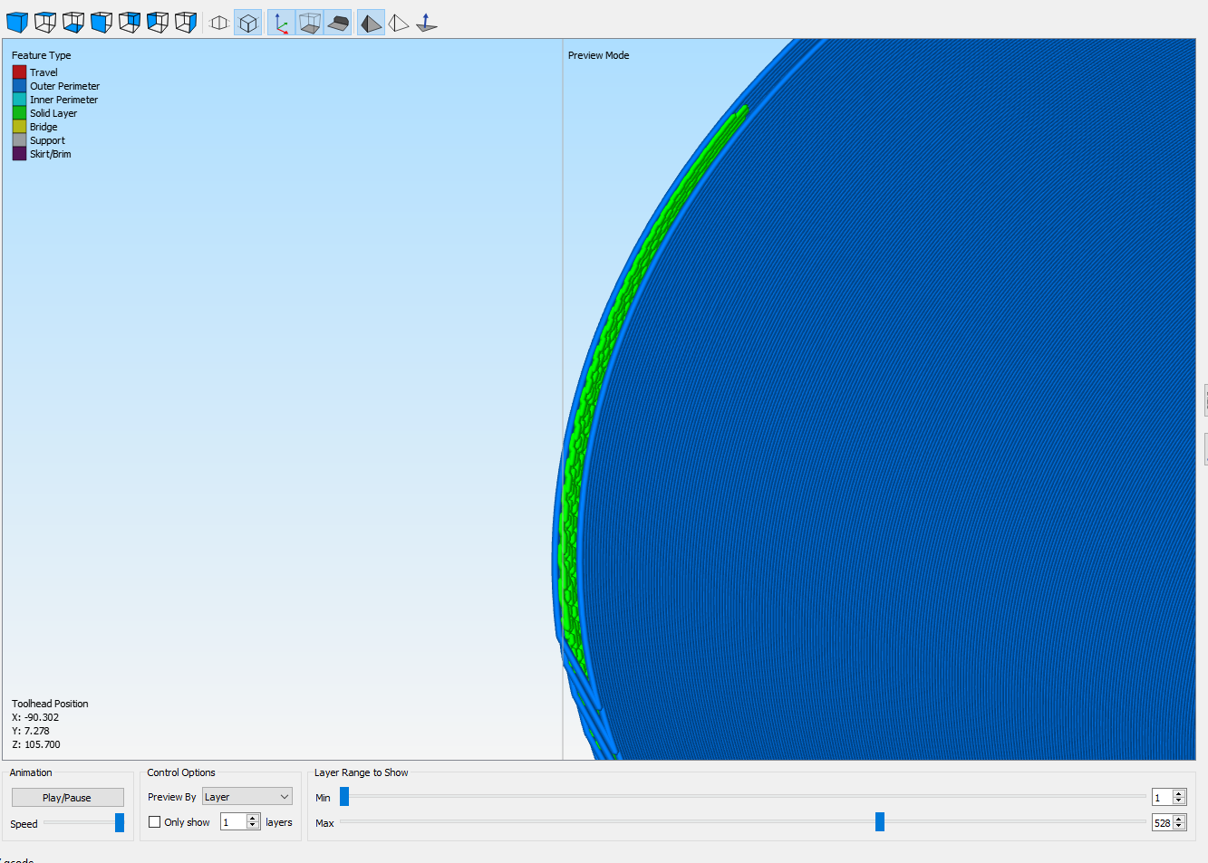

How to remove this type of solid layer
as seen in the attached image, no matter if i set infill to %0 ,there is a green type of solid layer in some area, what its called and how to set it off?

Might be related to the top and bottom solid layers. If you set both of those to zero, does it go away?

thank you so much , exactly was related to top layers
