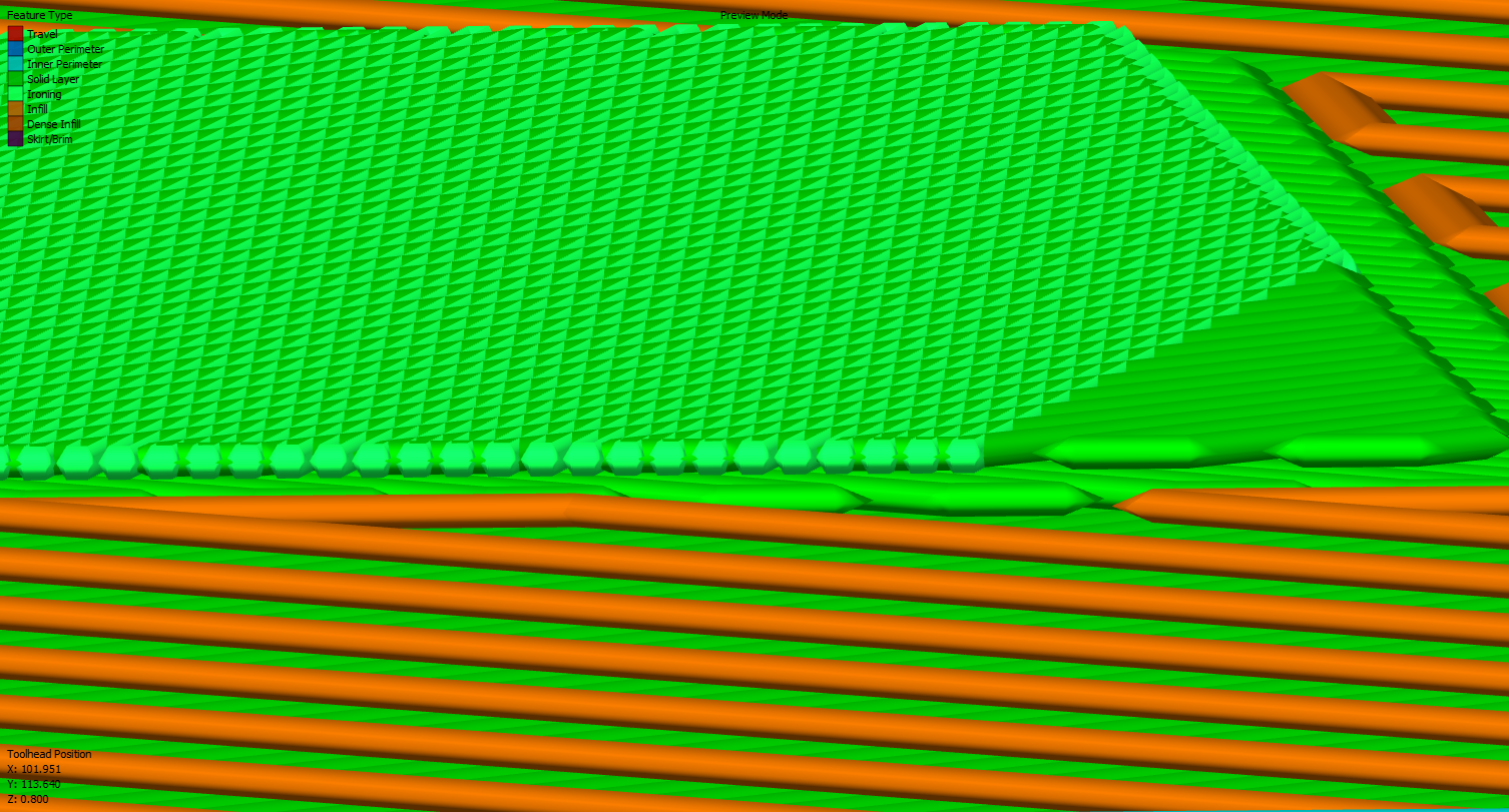

:?: I'm trying to understand what's happening here.
I have 2 different Process profiles, one was supplied by download by my printer's manufacturer bespoke for Simplify3D, the other is a default Simplify3D profile generated by the software for the Printer, but I have gone parameter-by-parameter through the tabs of the advanced settings for each profile and verified each profile's settings are identical to each other to try and figure out which setting caused this behavior, where instead of the top layer printing before the ironing pass happens, they flipped around and the ironing pass was happening over thin air where the layer should have been first, and then the layer was going down over ironing poops that couldn't fuse to anything.
The settings are below. What I found was, all of these settings can be identical in each profile, but it was the underlined speed % for Solid Infill Speed that seems to be causing this flip. When I set the speed to 70%, the layer irons as anticipated, when I set it to 50%, the layer malfunctions as described. Even if I set the default top level speed to an unreasonably high value like 80,000 mm/min or set it to an unreasonably low value like 800 mm/min, the ironing layer still operates backward to what it should, when I have the Solid Infill Speed set eg. to 50%.
I believe this is a bug? Or what correlation with my other settings would cause this behavior to occur? Thanks.

Yes, this is a bug. The workaround is detailed here: viewtopic.php?p=73670

Understood, so as long as Top Layer Speed != Solid Infill Speed the bug should not occur currently.
Thanks for that.
