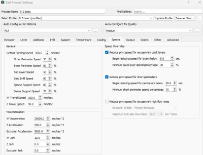

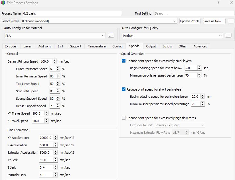

I cannot seem to reduce the xy travel speed. Typical settings for a slow print: print speed 100 mm/sec, XY Travel Speed set to 100 mm/sec. I assume this means when traveling between plastic extrusions there should be no discernible difference in speed right?
I just want to slow the travel speed way down as it's jerking/shaking my machine too much. What am I missing here?
*printing with a K1 Max
some of my printer settings attached as pics.
Thanks for any help or suggestions!
- Richi

Have you tried setting the XY travel speed to something much slower like 20 mm/s to see if that makes a noticeable difference?
If you export the gcode file for a small part you can also look at the actual F-values in the file to verify the exact speeds that it's using for each movement.
