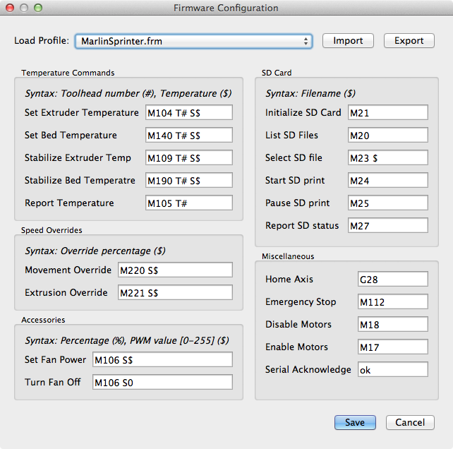

I'm really excited to see another solution come to the marketplace - so much so that I ordered it for my Makergear M2 as soon as it was made available (still waiting for the download link.)
One thing I haven't seen mention of is the firmware that Creator works with. Any details?

We wanted the program to be as versatile as possible so we actually built the core framework with that in mind. Specifically on the firmware side of things, there is a simple settings window where you enter any Reprap specific M-Codes (and some G-Codes) that are likely to change between different machines and firmwares. It comes preloaded with working settings for Marlin and Sprinter, any the modifications for other flavors should be fairly minimal. We'e always looking to extend the functionality, so if there's a firmware that doesn't work out of the box, just let us know and we'll see if there's anything we can do!

Looks like a nice implementation. Thanks!
