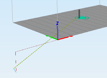

1. Under options/machine/ Which axis have to be flipped? x and y as far as I understood but this brings me ayway not around my major problem right now:
rigth after the startcode (I think) the extruder gets send way of the platform (or is it the startcode?) and I have to abort the build? Why ? any Idea? used your start code: same problem!! even the simulation shows what happens!

The main thing to keep in mind is that the Rep2/2x use a zero position in the middle of the bed. I have a feeling your problem is coming from the fact that you are using both a G10 offset and a G-Code X/Y offset to account for this fact. The G10 offset is placed in your start gcode and it is implemented by the firmware. So for the Rep2, this might look like:
G10 P1 X-140 Y-75 ; set local offset for Creator
G54 ; enable G10 offset
That tells the firmware to apply this offset to all commands, which essentially makes gcode that ranges from 0 to +280mm in the x-direction and 0 to +150mm in the y-direction get converted to the appropriate -140 to +140 in x and -75 to +75 in y. The nice thing about doing this with the G10 offset is that the preview in Creator will still be centered on the build table and will look like normal.
An alternate way to account for the Rep2/2x center position is to use the X/Y/Z offsets on the G-Code tab of the FFF Settings dialog within Creator. This essentially modifies every X/Y/Z coordinate in your gcode or x3g file by that amount. So setting the X/Y offsets in Creator to -140/-75 would accomplish the same thing, but the preview will be shifted like yours appears to be.
In the end, you only want to choose ONE of these approaches, and you should not need both. We typically use the G10 feature since that makes things a whole lot simpler for visualization purposes.

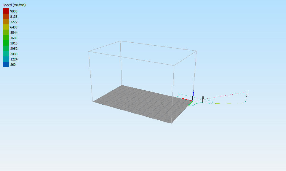

Phgeis
Posts: 21
Joined: Tue Jun 04, 2013 7:32 am
Re: Makerbot 2x(Sailfish) Basic setup
Now, taken care about the offset the build is where i should be, but the first move goes straight of the build plate. even with the "standard" rep 2 profile this happens.
