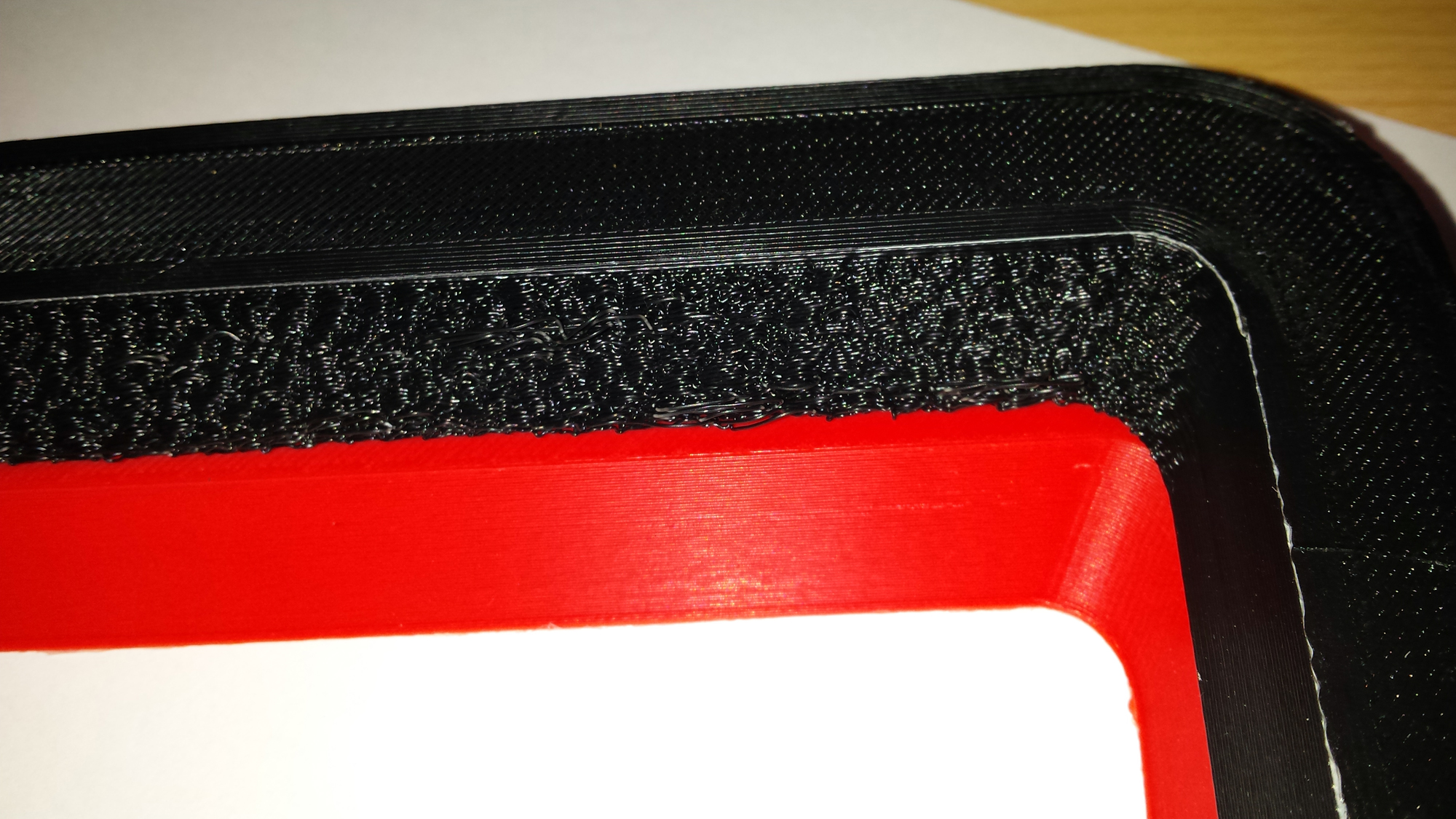

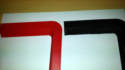

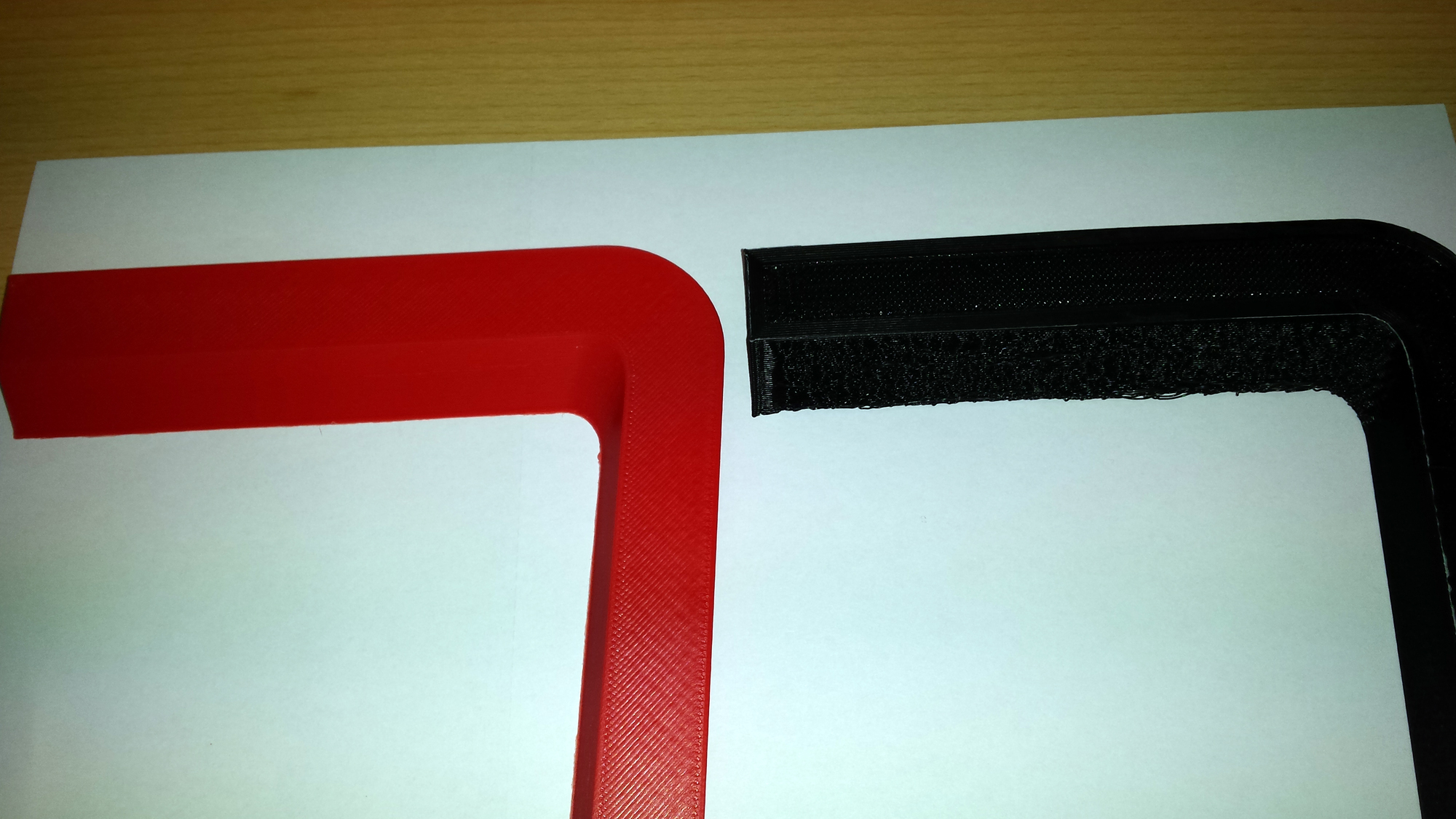

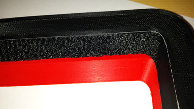

i also have the cubepro duo. if have tryed the ex1 profile with abs.
its way better then with the original software ;-)
here you can see the different ( black cubepro software, red simplify 3D, printed in ABS ):

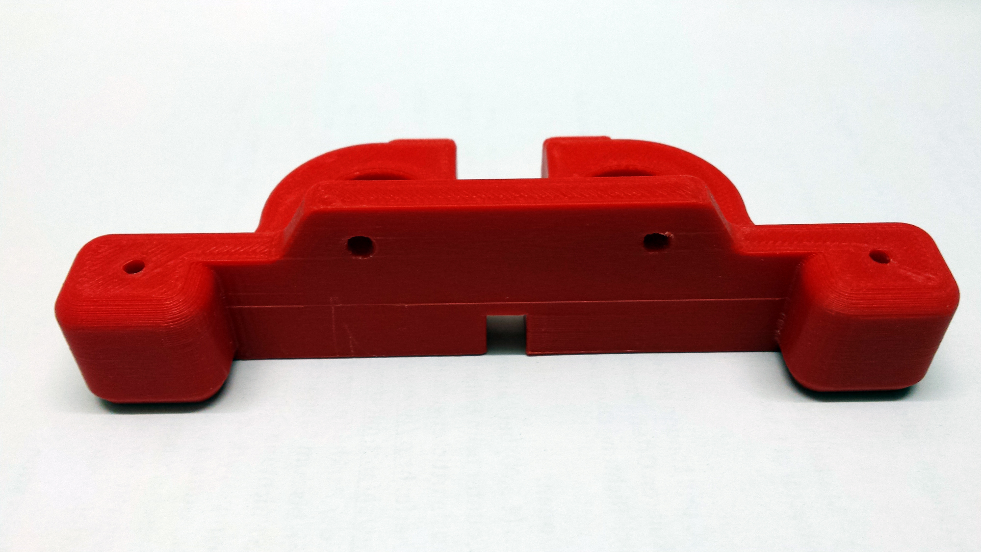

i have done the nextprint, with rafts and support:
i must say simplify 3d just unleash my cubepro ;-)
thanks to @MichaelHerron for the profile!

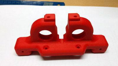

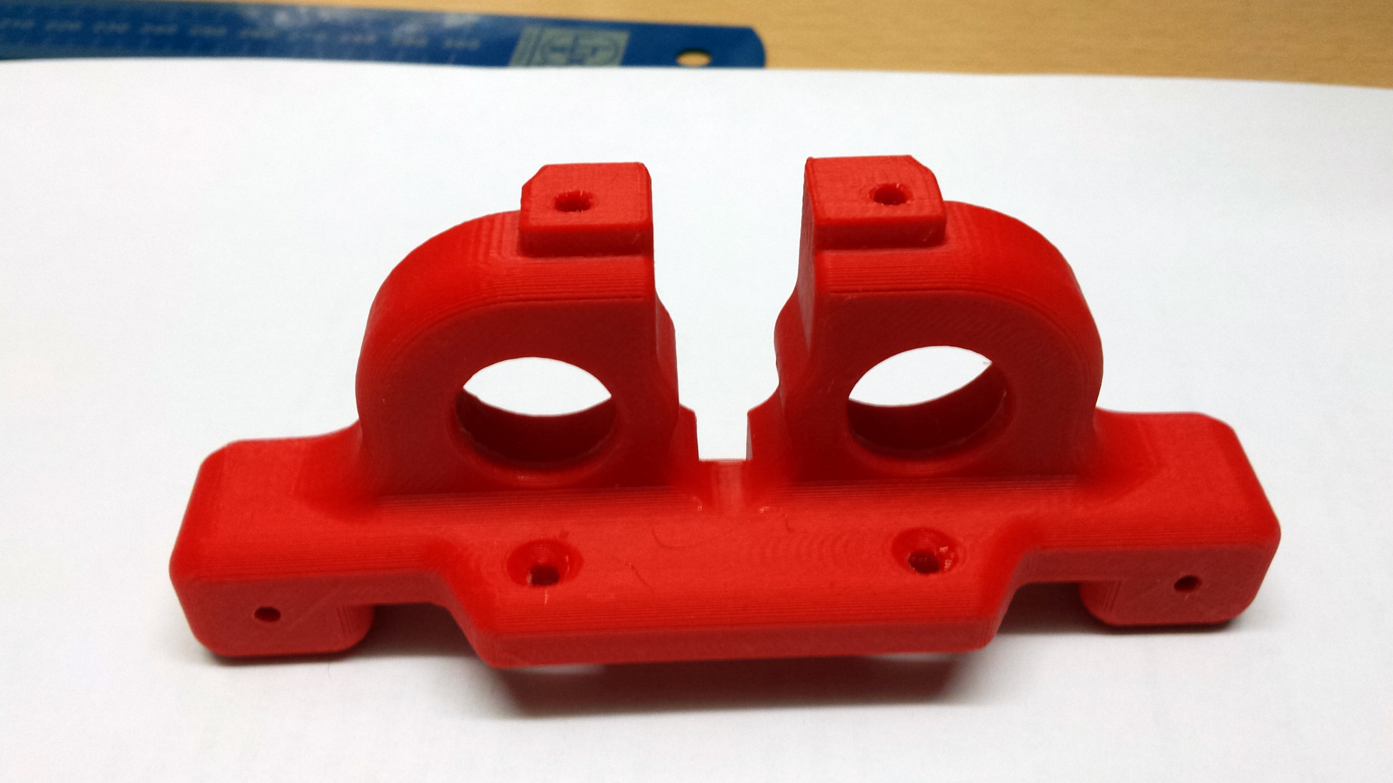

Here's my print done on a CubePro using Simplify3D
Thought it came out nicely!
