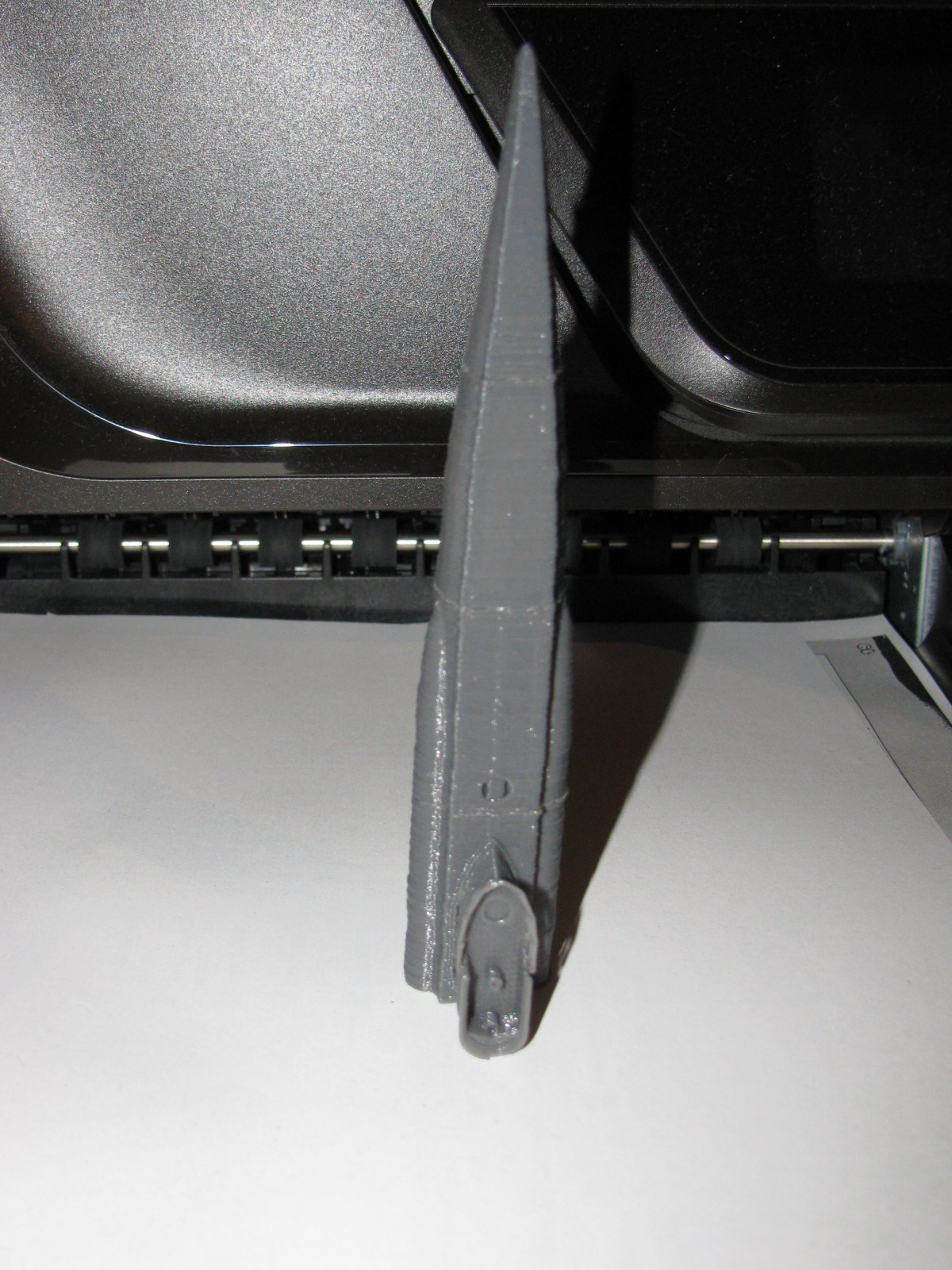

it was printed in PLA at 210°C. Attached a picture, the parts were oriented differently in this case, but with the same result. Checked them in gcode.ws with no strange results...

We have a genuine mystery on our hands. Do you have any photos of the Cura prints?
I was expecting to see some higher speed moves or rapids in the S3D gcode that might cause a physical skewing due to skipped steps or belt slippage, etc. But the speeds between the two gcode files are very similar. Do you notice any difference in sound when the parts print? Sometimes audible feedback can give clues.

Have this problem at even more stl's, and as I said always when there are more objects to print or with more complex parts. As an Example an picture of an segmented U-boat is attached, I used a bad filament with massive changes in diameter, so don´t look too close...
BTW, the wing rips print fine individualy.
Even made a singe stl-file for these rips in Autodesk Inventor but this doesn't help either.
Also checked the stl's in CAD but nothing strange here.
