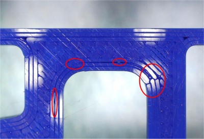

OK, while I'm waiting for Airscape's print to finish, I took a look at other regions on the bottom. There are two internal holes in the model, and the photos I've been taking have been of the perimeter around one hole. I get the same issue of the 2nd perimeter underextruding & leaving gaps around the second hole:

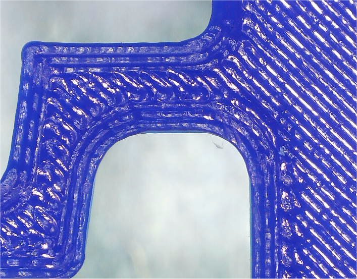

We have a winner! Thank you Airscapes! I really appreciate the time you took to help out with this.
I just fished the print off the printer, and the gaps are gone! Here's the top side:
And here's the bottom, showing a clean start to the 2nd & third perimeters.

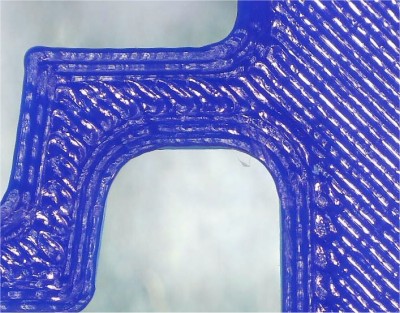

Despite all sorts of changes, the only minor "quality" issue I noticed is some "ghosting" of the internal voids that wasn't present with my settings:
This has Airscapes' version on top of one of mine. The depressed region is pretty small (small enough it's hard to photograph), and for the project at hand, it won't be an issue.
