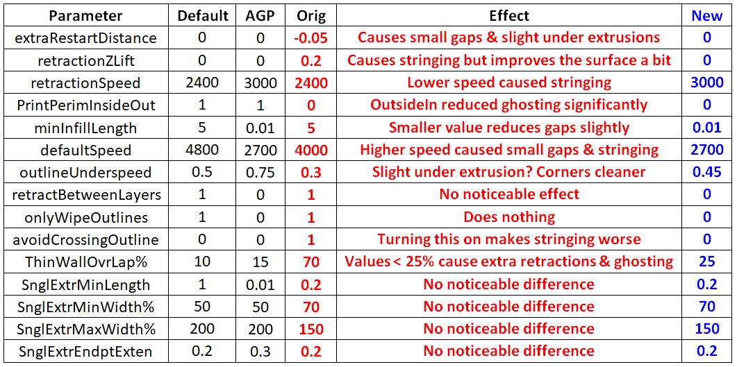

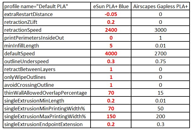

I got all three processes into Excel, combined them all on one sheet, and then thinned it down to the essential stuff. I ditched things like support & raft settings, which aren't involved.
I've attached a PDF that has the differences in settings hilited, using Airscapes's gap-free process as my "gold standard."
A lot of the differences are minor, or should have nothing to do with the gap problem, like my fan speeds.
Here's the really condensed version of the differences I think may be involved
As time & printer availability permit, I'll start modifying my process to match Airscapes and see if I can find the critical setting(s) that cause the gaps. I think I can speed up the process by using a binary search approach. I'll try the top half of the settings, and then the bottom half. That should narrow it down a lot quickly.
Perimeter Gap Analysis Process Comparison.pdf
(69.7 KiB) Downloaded 1066 times

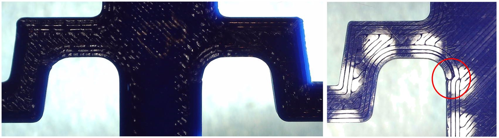

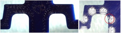

Curiosity got the better of me, and I ran a test over dinner. I started with Airscape's gapless process, and created two new processes. "Test 1A" had my parameters inserted from the top half of the table posted above, and "Test 1B" used my settings from the bottom half. The break was between "outlineUnderspeed" and "retractBetweenLayers".
Here is the result for Test 1A:
and here is what I got from Test 1B:
So, whatever settings of mine that are causing the gaps are contained in this list:
The ghosting I observed in the original gapless print has disappeared in the gapless Test 1B print.

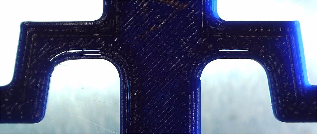

Test 2A was Airscapes's gapless process, with three settings imported from my gappy process:
extraRestartDistance = -0.05
retractionZLift = 0.2
retractionSpeed = 2400
There is one section of the inner perimeters that shows a small narrow gap. Viewed from the bottom, the start of all three perimeter passes looks consistent in width. Basically, something in these three settings is causing a gap, but it's much better than before.

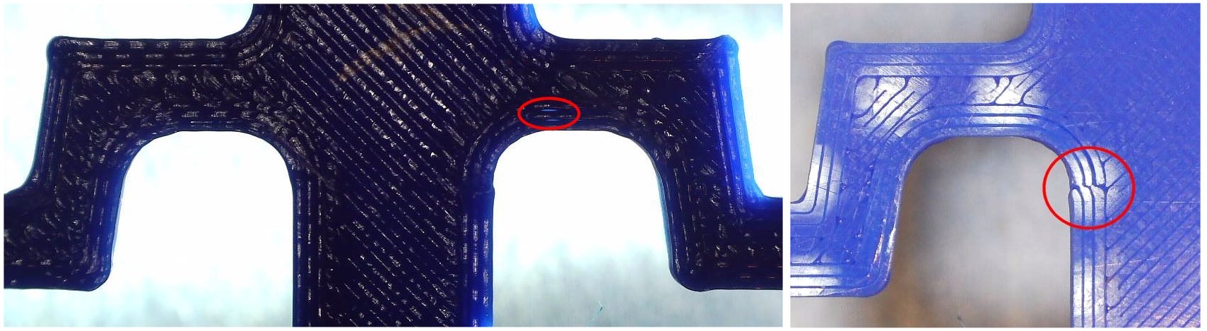

I ran another set of tests with just the Extra Restart Distance and Z-Lift parameters in play. Both state with Airscapes's gapless process, but with a single parameter change to the values from my process that creates gaps.
Test 3A: ERD changed to -0.05
There is a single tiny gap that you can only see with strong backlight. It's nothing compared to the original problem. On the bottom, you can see three fairly even perimeters, with no obvious under extrusion. There is a small bump of extra material at the end of the final (inner) pass. The extruder is going counter clockwise, from inside to outside, so the inner most pass is the last one. The bump occurs at the very end, so it shouldn't be related to ERD .
Test 3B: Z-Lift = 0.2
This had another miniscule gap, and on the bottom the extrusion looks pretty even between the three passes. The bump seen in the test with ERD = -0.05 is absent.
Because I'm now dealing with increasingly small gaps, which require looking very closely, I also went back & double checked Airscapes's process. I couldn't find any voids or even thin spots where the back light shines through.
Extra Restart Distance appears to be involved, but the defects it caused by itself are very minor compared to the original problem. I probably never would have noticed them if I wasn't looking VERY closely. I haven't identified (yet) what caused the large underextrusion that I think is a major part of the problem.

After lots of experiments, I think I have things pinned down. The gaps were the the result of a combination of settings. The biggest contributor was the Default Speed, followed by Extra Restart Distance, with a tiny effect from the Minimum Infil Length. In the course of chasing this all down, I discovered a few other things. The "ghosting" of internal features on the exterior walls were caused by a combination of the print order (Outside-In is better), and the ThinWallOverlap. If the Overlap is set below ~ 25%, it requires extra passes & retractions to do some of the walls (at least in this model), and that contributes to the ghosting.
I put together a table that lists the default settings for the MakerGear M2E, Airscapes's Gapless Process ("AGP"), my original process that had bad gaps, the effect of my settings vs Airscapes's, and finally, the process I settled on. It mostly uses the AGP settings, with the major exceptions being the print order and the Thin Wall Overlap to eliminate ghosting.
One other thing I found is that the Zlift helps with the quality of the top surface because it avoids dragging the nozzle across features that have already been printed. When I started out with a 70% Thin Wall Overlap, it was over extruding, and the top layer had a lot of bumps that the nozzle dragged across. I originally found the 70% setting necessary to fill in around inset text on the bottom layer for other jobs, but it doesn't need to be that high for most of a print. For maximum top surface quality, you can always turn on Zlift with a process set just to run for the top layer.
In any event, I've learned a lot, and I now have a process that produces much nicer results that what I had before.
Thank you Airscapes!

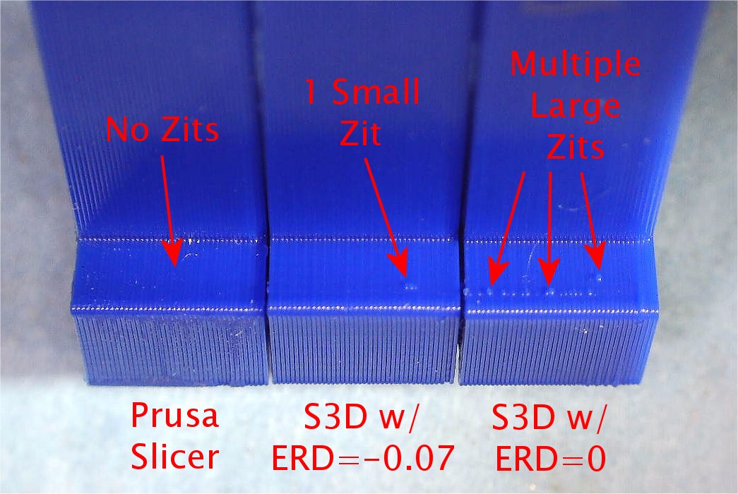

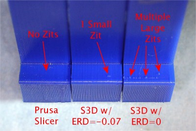

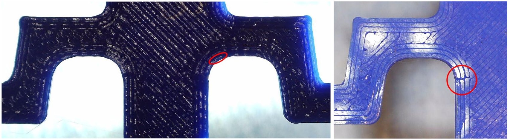

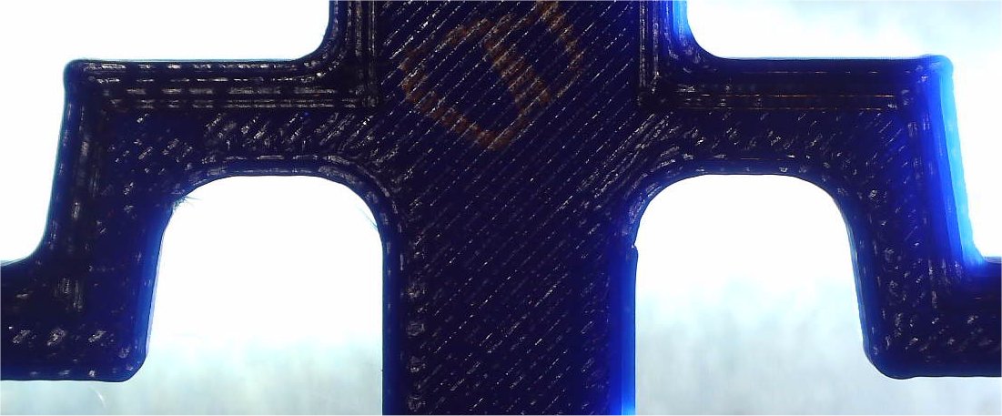

Well, there's more to the story. Once I went back to a larger version of my model, I discovered that without a small negative Extra Restart Distance (ERD), I was getting "zits" on the faces of some dovetails I'm using to built a larger overall structure. I could clean them up by hand, but that is going to be very tedious. I can get rid of most of he zits with an ERD = -0.07 mm, but as soon as I do that, I get gaps in the perimeters again, despite all of the other changes. ERD's around -0.01 or -0.02 don't have a noticeable effect, but by the time I get up to -0.07, the gaps are are quite evident, and appear to be the result of under extrusion.
I really think this is a bug inS3D. The ERD should only affect a very small effect at the beginning of a perimeter pass. I'm seeing under extrusion that lasts for many mm, and in some cases, almost a cm.
I tried the test models in PrusaSlicer, and without any tuning of the settings, I get prints with no zits & no gaps.
Here is a comparison of the S3D processes with ERD=0, ERD=-0.07, and Prusa Slicer ("PS"). The first shows the zits I was getting on the dovetails:
And here is a comparison of the test file where I get the gaps:
PrusaSlicer doesn't have as many options for fine-tuning things, but their default algorithms seem to work remarkably well. The one thin arm where S3D tries to use 3 extrusions to make a 1.5 mm wide wall with a 0.40 mm extrusion width, PrusaSlicers sensibly does it with 4.
I'm going to report this to Tech Support, but for now, I have no choice but to switch to using PrusaSlicer. I don't like many aspects of the user interface and the way they store printing parameters in a bunch of separate places, but if it's the only way I can get quality prints, I will have to learn to live with it. Of course, if this is a bug, I can't expect S3D to ever fix it, given their track record on updates for the last 2 years...
