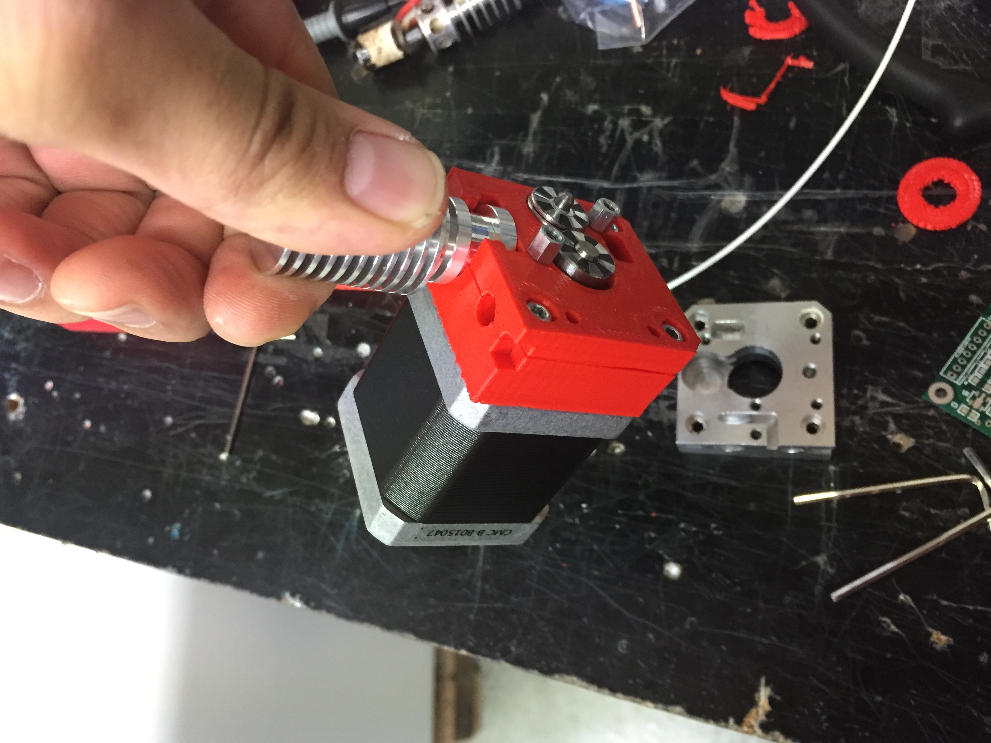

I just stumbled upon this thread, and it seems it could be helpful for my problem. I have a CubePro with a busted extruder from almost a year ago, and I'm planning the following:
1. Replace the original extruder for an E3D v6 all-metal hotend one, for cheaper and better quality (IMO) replacements. I already designed and assembled a new extruder block for it (attached stl and f3d files), and it feels sturdy enough.
2. Replace original control PCB, user interface, and power supply so as to have the CubePro as a Marlin 3D printer, for ease of use and configurability.
3. Configure Marlin firmware accordingly.
But it seems that there may be another way with the original electronics simply through gcode. I'm thinking I could simply try to have a certain Z-offset of the original extruder vs. the new one, and a remapping of the new temperature readings vs. the old ones. That last procedure seems easier said than done, but I'm guessing I could characterize the new temperature curve's readings around printing capability, and set those new temperature values as the extruder's temperatures, depending on material.
I hope your extruders are OK, but I think most of us would like to not depend on 3D Systems' expensive and unmaintainableish replacements.

Sorry for the late reply--If you print VERY slow its theoretically possible to print with flexibles. It would be far better to replace the extruder/hotend/Main PCB, however. It isn't terribly difficult to do, but it is an extensive rebuild and you'll need to design a custom carraige platform to match your chosen extruder/hotend. You will also need a VERY long hotend to reach past the HUGE bearings for the carraige. If you are brave, you could replace these too.
Good luck! I've gotten very good prints from my re-built Marlin CubePro, but its a single extruder--down from the Duo that it came with. It does have an amazingly fast 1000W 120VAC aluminum heated bed and an E3D V6 / Titan extruder hotend. Still, I'd personally recommend just getting a Creality printer. Rebuilding this monster will cost more than a new Ender 3D. Once you're up and running with the new printer, you can rebuild the Cube with printed parts, then sell it for something (far less than you paid).
