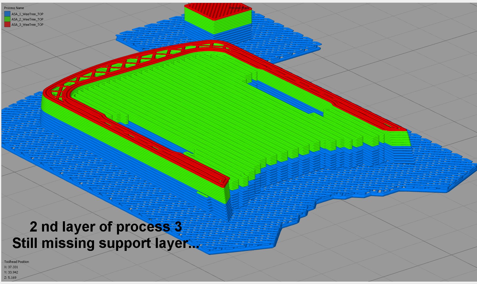

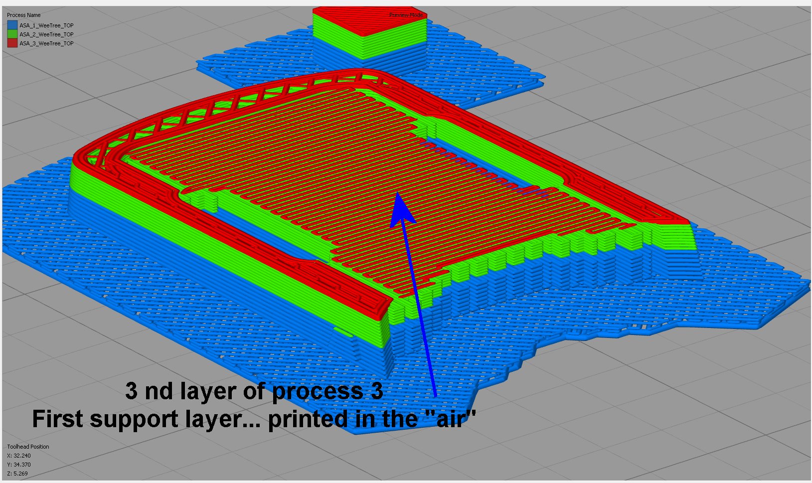

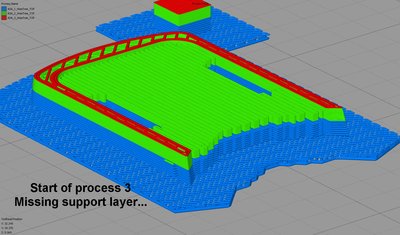

When Simplify3D changes process, it seems to miss two layers on the support. As shown in sketches, it clearly shows where the layers are applied right after the change of process 2 to 3. At the third layer, the support suddently resumes. This makes the layer of the support printed into air and creates havoc on the building of the part.
The different colors represent the 3 different processes. The main change between process 2 and 3 is in the layer thickness. I start with a layer thickness of 0.3 to finish with 0.1mm.
I can send my GCode and factory files if needed.

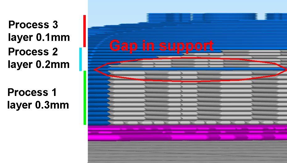

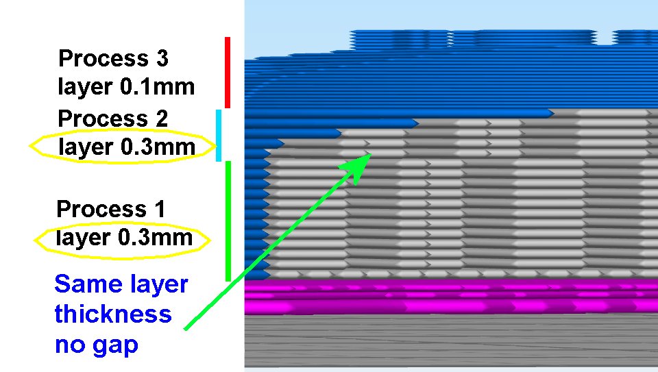

Thanks Doug and AirScapes, the post viewtopic.php?f=8&t=1973 got me a partial solution by setting the "Upper Vertical Seperation Layers" and "Lower Vertical Seperation Layers" bettween the processes. However this works only if the layer thickness is the same between processes as shown on these images:
I hope this bug will be corrected on the next version of Simplify3D

When I cliked on the HELP / CHECK UPDATE menu, I got the message "Software up to date" and my version was 4.01. Still not to take any chances, I desinstall and reinstall Simplify3D. To no avail, I still get the problem. I added my factory file with the layer of process 2 change à 0.2mm. Can you check if you get the gap in the support layer? If you change the layer thickness of process 2 back to 0.3, you should't have any problem.
