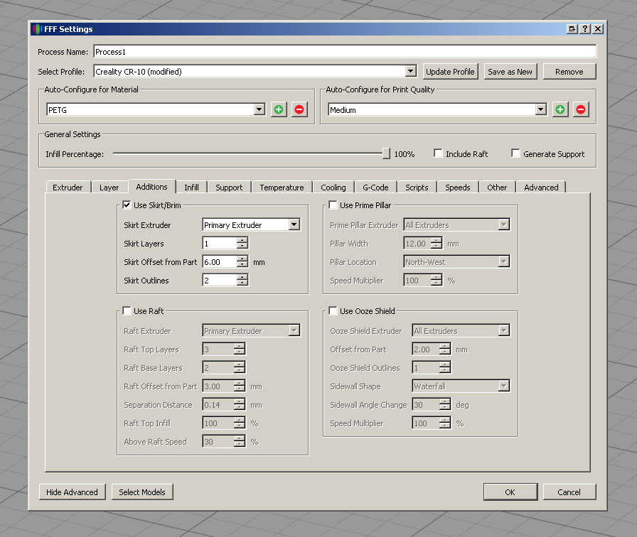

Anybody have any idea why when I select User Skirt/Brim, it doesn't print the skirt for some jobs?

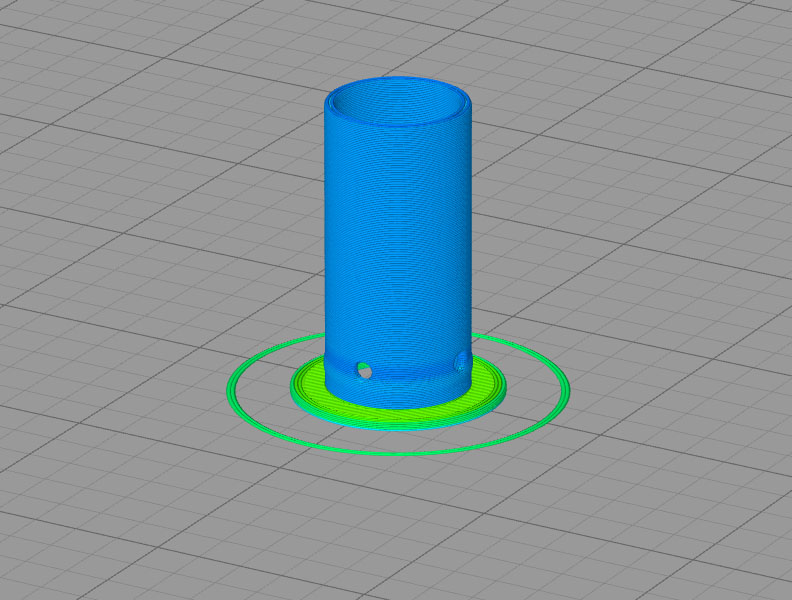

Doesn't print

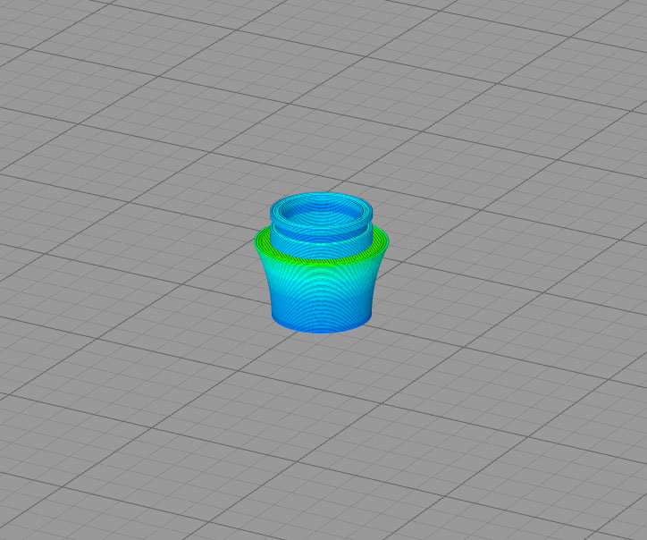

Prints

Re: Skirt selected, no skirt printed
I understand you're not interested in my advice...….but I'll give it anyway!!!!!!
I think your first part is not touching the bed....hence no brim!
And in future, please don't be rude!!! And apologies for not spotting your post sooner.
[FIXED] Re: Skirt selected, no skirt printed
I’m happy to state that this issue should be resolved now in the latest 4.1.0 release. Our team successfully tested several factory files from threads mentioning this issue. When you have a Start At Height set in your process' advanced settings, you can see that Skirts will be allowed to be printed in air when you want them to be. This was just one of many improvements to the software. All of which are detailed on our Release Notes page.
