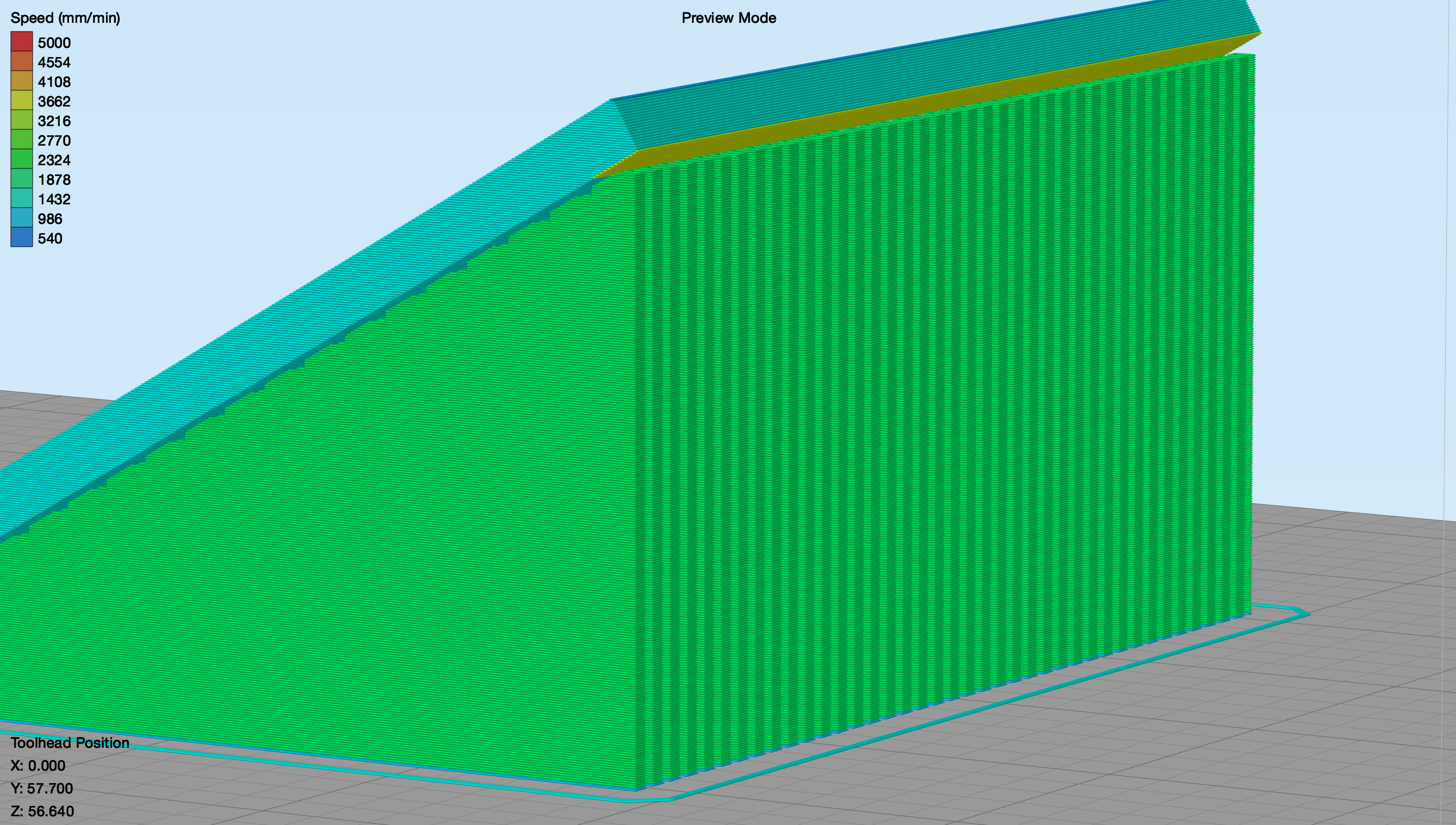

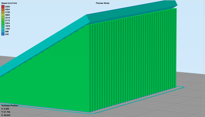

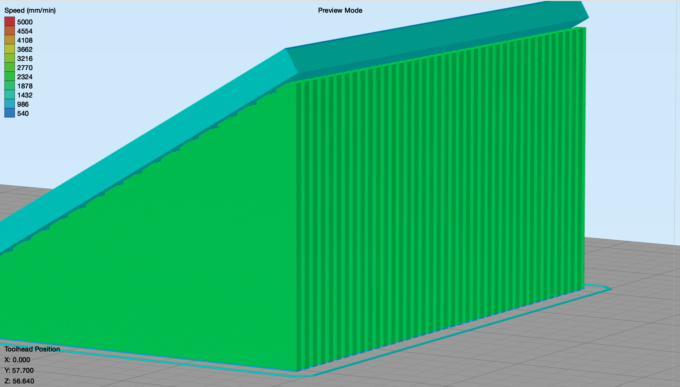

In case you haven't tried it already, you can currently tweak your bridging settings (particularly unsupported area threshold) to have bridging overrides applied to large enough areas printed atop supports.
Default:
5mm Area threshold, Bridging Applied to Perimeters, and 150% bridging movement speed:

Ok thanks. Yes i had already this bridging setting set as shown.
