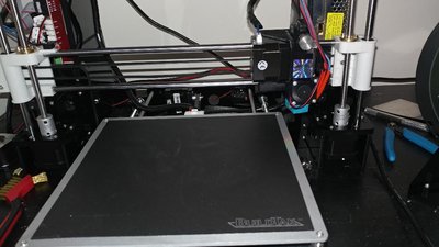

Having issues with my printer/software. Doing the bed leveling wizard shows that my X and Y axis are way off. I'm not sure how to fix this. I have the Anet A8 3D Printer.

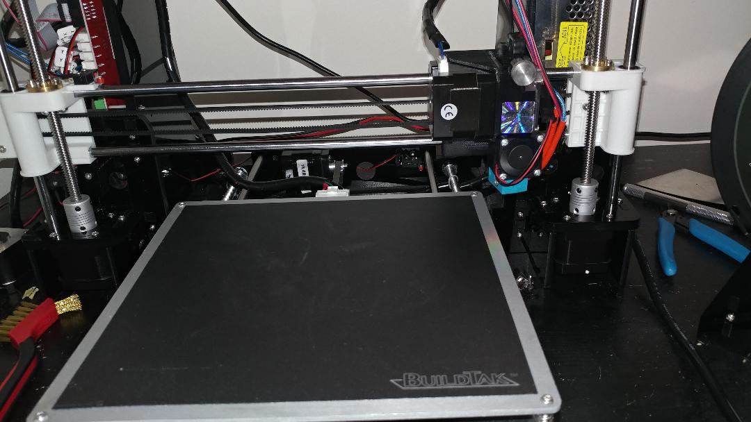

Sorry, I Zero all of the Axis then perform the Leveling Wizard. It will move on the X axis by about an inch (still on the bed) the second move it moves to the opposite corner about an inch or so off of the bed. The same thing happens when I try to print, it thinks it's bed is an inch farther than the Zero axis. The picture is to show how far it thinks it is off. Not sure if this is a Firmware issue or a Software issue :(. Not sure how to test.

I think I know the issue. I upgraded the print head to the E3dv6 with the titan extruder and it came with a mount for it that moves the print head over about an inch (found this out by homing everything to "0" and seeing where the hotend was). Next question.... How do I go about updating it to fix this?

I found a way to fix the issue I was having. I went to the G-Code tab and added 20mm to the X and Y axis. The printhead now goes from corner to corner without leaving the bed. Thanks for you assistance guys :D
