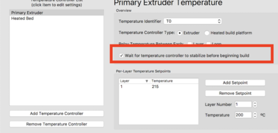

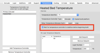

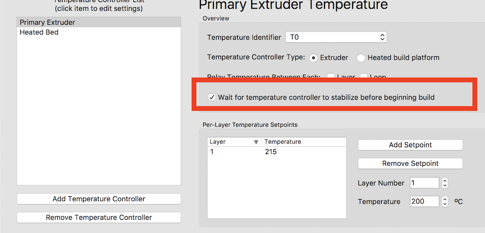

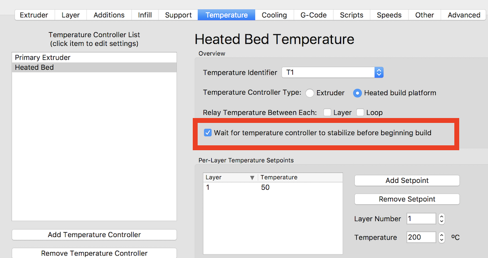

The Marlin firmware will do as it’s setup.
But, the G-Code in Simplify (and others, such as Slic3r) will make the printer do as you want.
For Simplify3d:
Set the checkbox as shown (no need to add G-code script)
If still having problem, add the command script to the Script Panel in the Process, command it to wait:
M109 S230 ; wait for extruder to heat
I'm 70 and 3D printing makes me feel like I'm 16!
