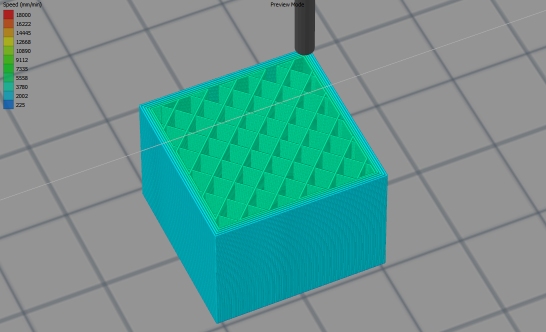

Why not make the cube solid and reduce the infill percentage to a low values such as 10%, like this:
Am I missing something?

I dont see the difference between wanting supports to be generated in a closed hollow cube you and adjusting the infill percentage on a solid cube? If you're not going to be removing the supports from the inside of the cube wouldn't it be easier to just print a solid cube with low infill?

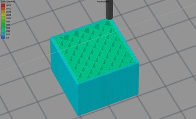

Just for grins, I also found that if I add a 1 mm hole to the top surface, it causes the void to be supported. I haven't tried making the hole smaller and smaller to see at what point the slicer ignores it, but I bet it could get quite small.
