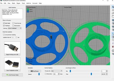

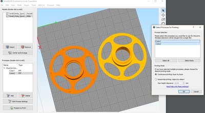

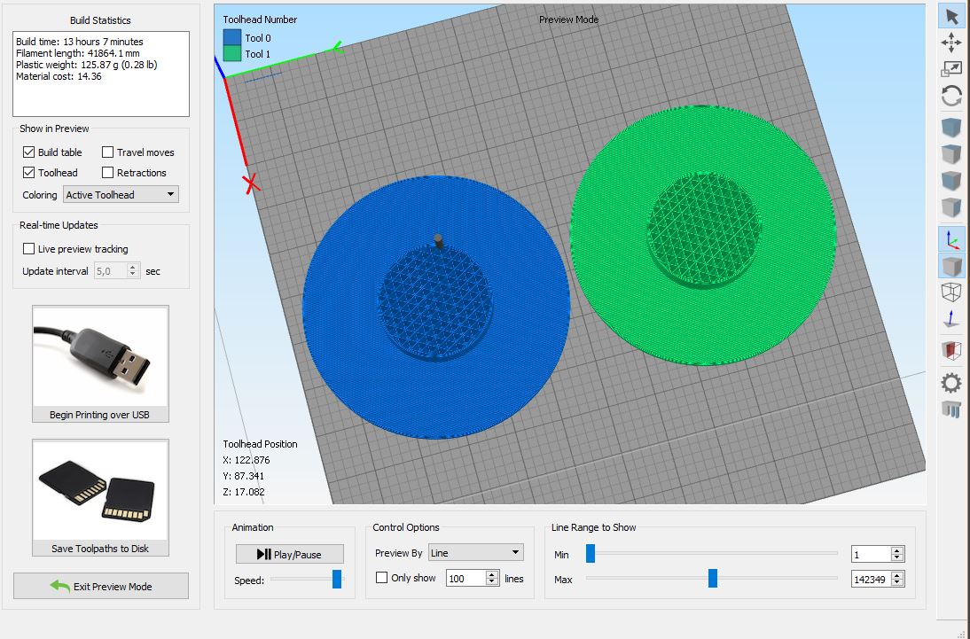

i install and do some rare thing
if i made the dual extrusion wizard
i get
both parts full filled
if i dont do the wizard, manually use a tool 0 and tool 1 to each model i get it correct, BUT in dont change filament on printer, change tool but no retraction so get stuck :|
