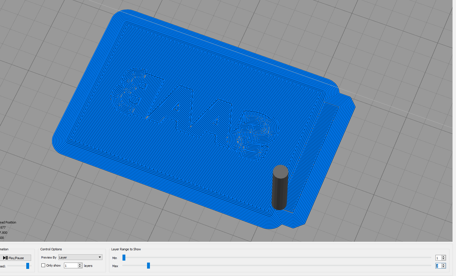

Trying to print a belt buckle for my dad.
the problem starts at the second layer. its suppose to make dense infill but starts making weird stuff, see pic.
is there a way to make the infill continue over the previous layer

Looks like you may have some overlapping or non-watertight geometry. Use the mesh diagnostics in the Repair tab, or Meshmixer is also good at finding and fixing mesh problems
Re: text on surface Problem
A simple fix I think....use the "Separate Connected Surfaces" option on the Mesh dropdown.

Okey! Thanks! It worked using separate connected surfaces :)
