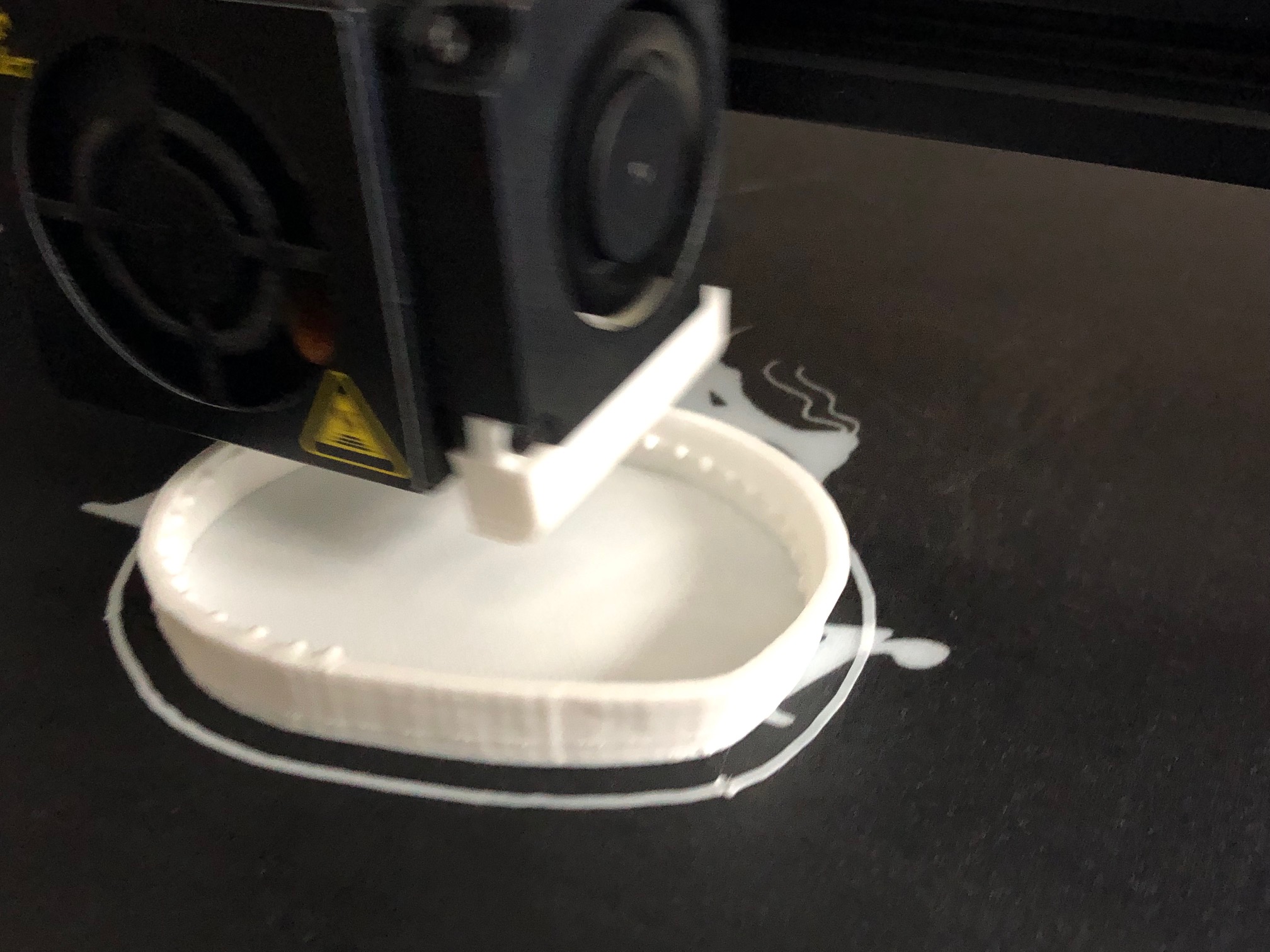

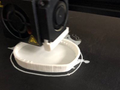

i do have a part only with 5 outlines.
when a new layer starts the retract does not work properly. to many filament will be pressed out and on each layer bubbles appear.
any idea what can be done?

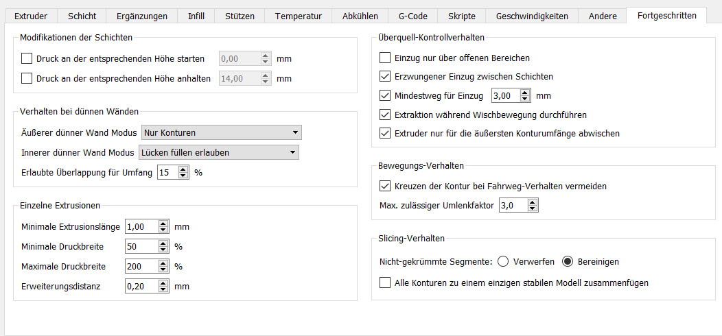

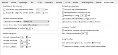

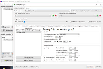

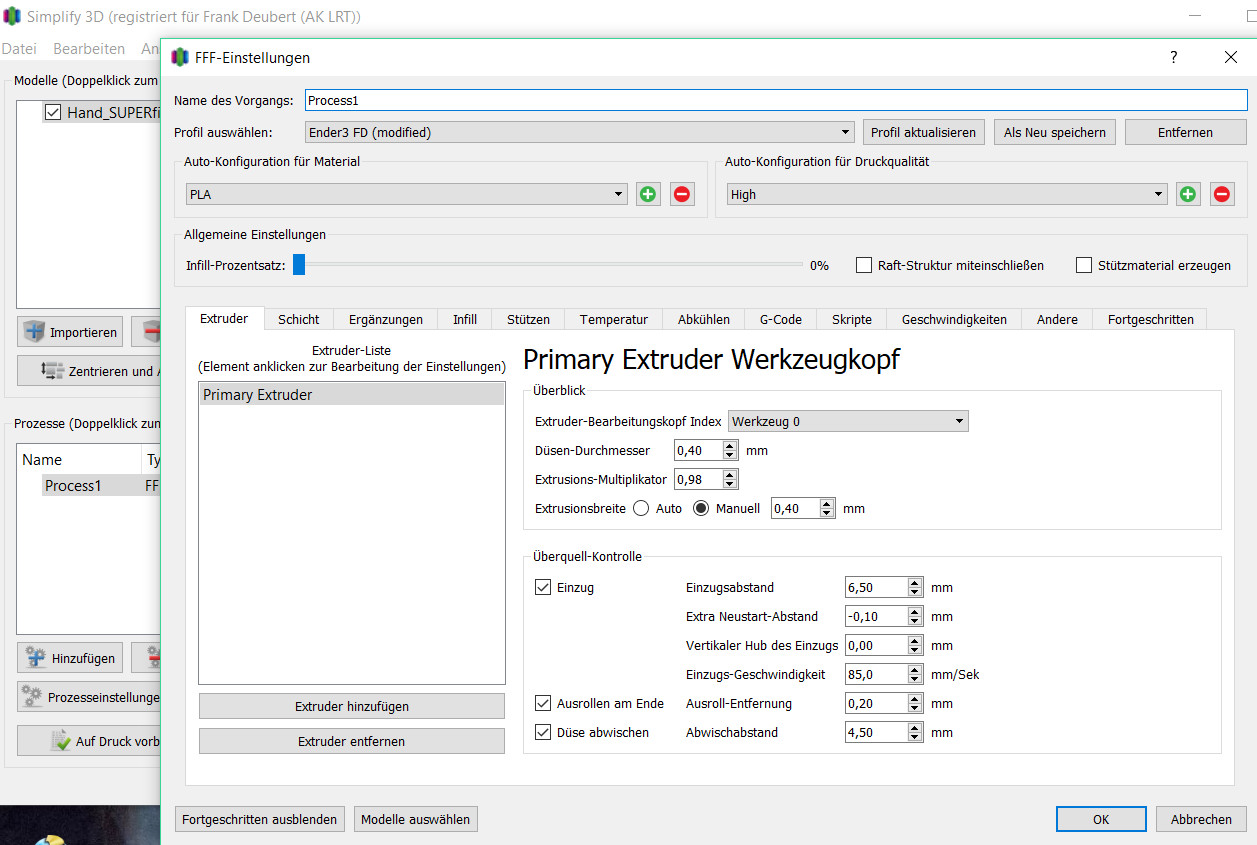

attached please find a foto and the settings i used for retract (this are the same settings i used on previous versions)

I have found that in addition to force retraction between layers "preform retraction during wipe movement" must also be disabled for retraction to. work properly.
