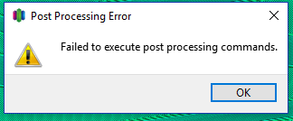

Hi there,
I got S3D 4.1.1. When I try to save my GCode on my NAS, i get following failure. There's no problem when I want to save my GCode on my computer.
When I manually check the location, there's a GCode Temp-File in it with PROGRAMNAME.gcode.temp as name.
I also compared both files, they match 100%
Any advices how to get that away?
Greetings from germany,
Dennis

same problem, S3D v4.1.1 running on both Macintosh and Windows. Message "Failed to execute post processing commands" keeps popping up after saving almost any gcode to a network path. It's happening as well when saving gcode to Toshiba FlashAir webdav share.
Note that saving the GCODE file onto Desktop and copying to the desired network drive works without problem. Local gigabit network or slower wifi, does not make any difference.
this problem did not appear in version 4.0.1 at all. Never seen that message in 4.0.1

After working with another user, the issue with running post processing commands seems to stem from the use of unicode characters (ä, ö, ü, eñe, kanji, etc...) in the file name or file path. Does your network storage or the name of the file you're saving use these unicode characters?

nope, no special characters nor long path in my case.
http://10.0.0.9/ is mounted as /Volumes/10.0.0.9 with flags webdav, nodev, noexec, nosuid
if my problem came from some problem with path, it would happen every time. Sometimes it's enough to save the (previously saved with zero length + error message) file again and it saves correctly.
is there anything I can do to help identifying the problem? Does S3D log somewhere? this error message I'm getting with 4.1.1 is quite generic and does not say much

I'd try setting up another mount point without those flags for your G-code files to be saved and post processed. Post processing is executing commands on the already saved G-Code file, so at the least I'd suggest taking off the noexec flag.

did not help unfortunately.
note that this is standard Mac disk mounting result. To be fair, it should work when I map the disk on the mac by pressing CMD+K and putting http://flashair_ip/ - it mounts and I should be able to use this drive.
I'm currently using version 4.0.1 which does not have this problem, at all. Also does not suffer from any vase mode problems
