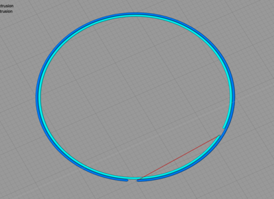

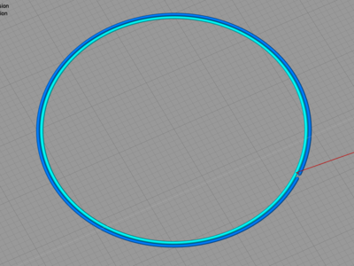

I'm running into an issue which seems impossible to fix. The fact that there is an option for fixed, optimised or random start points is very convenient, but there is something that doesn't make any sense. When I select 'optimise', the end of the inner perimeter touches the start of the outer perimeter (= very short travel move). But when I select 'random' (to make sure there is no line shaped seam), the end of the inner perimeter is on a different place than the start of the outer perimeter. It looks like the start of the inner as well as the outer perimeters are also random, but relative to each other, which is something I can't imagine any useful application for..
Random
Optimised

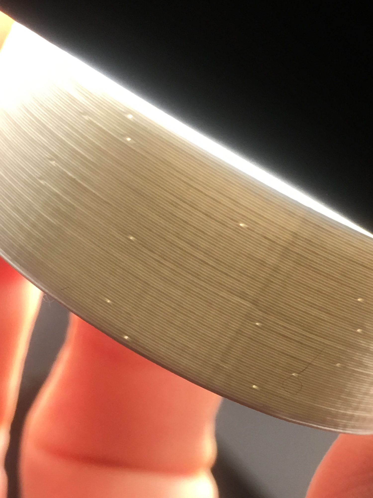

This end to start travel move creates a tiny gap at the start of the outer perimeter. Which I think is caused by the filament pressure that drops when the printhead travels from the end of the inner perimeter to the start of the outer perimeter.
These are the gaps I mean.

I know, random is the option I select to prevent a seam, but instead get speckles all over the print, which is totally understandable. But there is one flaw.
The problem with 'random' compared to 'optimised' and 'fixed', is that random creates a different start point for the inner perimeter(s) as well as the outer perimeter, independent from each other. This often creates a (longer than needed) travel move after the end of the inner perimeter when it heads to the start of the outer perimeter. This travel move is totally unnecessary.
The start of the inner perimeter should be randomised, BUT after the inner perimeter finishes, it should travel to the closest possible location to start the outer perimeter.

the gaps in the first images look like too much coast .
